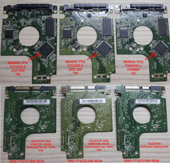

I have two harddrive Western Digital 320 GB 2.5 with same PCB 2060-771682-004 Rev A
One of is completly crashed and Windows can not see this Hard Drive
other harddrive is working perfectly I change the PCB and change the bios too with working PCB but still do not work
I think the bios is damaged because the other working bios is work with two same PCB s
Please help if you have any idea
Is there a way to fix the bios

i think bios is correct. problem in hdd. if you need data from this drive then bring to data recovery company.

marsakcil wrote:Hello,
merhaba
did you try the other pcb without changing BIOS, does it spin that way ?
Re: Western Digital Bios Problem
July 9th, 2015, 13:06
Yes I try it starts to spin but not to start recognize. So Operating system does not give any sign about harddrive.
But another detail** healty bios (I think ) Works with two PCB without any problem spin and recognize..

is the main IC chip number same?

Tekrar selam hepsinin PCB numarası aynı sadece 1 HDD sağlıklı çalışıyor ve dataları gösteriyor
Hi Again all the PCB numbers are same, one of the harddrive ( right one ) work as well and can Access data.

most likely problem is not PCB, could be FW, bad sectors or heads.
If data is important i would suggest to contact a DR company.
