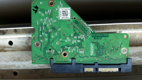

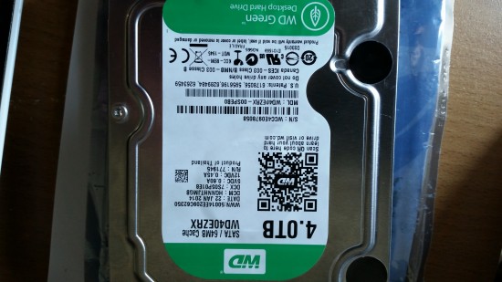

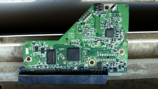

I have a 4TB WD My Book and I accidentally plugged the wrong power adapter and now the HDD (and Enclosure) is dead. After a half-baked research and making a brand new 1TB WD Green useless now... I found out that i could still revive the HDD and backup the files if I could get a new PCB or somehow make the broken one work again. Can someone please guide me on what to do? I did some research about Buying and identical PCB and something about the TVS diode but with all the info in the web and inside this site is really confusing me. I just need some solid directions from people who have actually revived an HDD so I could find the right info and hopefully save my wallet form spending on things that will not work in the end. Thanks.

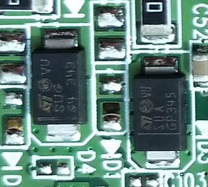

If you are lucky only the TVS Diodes are blown. Just check them as in the picture below. The "big ones"
But beware!! If you unsolder them if you found out that they are faulty (please don't cut them) and there will be again an oversurge your data could be unrecoverable!!!
The oversurge could have blown other vital parts.
If your Data is important and I bet it is. I would not recommend a DIY solution.

Okay I watched some more videos and learned a few more stuff... I used the X1K setting and adjusted the dial so that when I connect the red and black probe the multimeter will point to 0ohms.
And what I did next was to test the 2 TVS diodes that BenDataRecovery pointed out.
Please refer to BenDataRecovery's screenshot attachment (the 2nd topic post)
Left TVS diode = 0 ohms
Right diode = 1.8 ohms / 50 ohms - different result when you reverse the probes
Based on the FAQ the TVS diode on the left is dead and the one on the right is alright. Am I correct?

OK, so now just heat up and remove the left TVS diode that is shorted and see if the drive works. :D
Sounds too simple to be true, but very often it works. Just be sure you're on a good power supply preferably connected to a UPS battery as the drive now lacks the TVS protection that keeps the other components safe from surges.

I would confirm that zero-ohm resistors R88, R60 and R64 measure 0.0 ohms. The motor controller IC has not suffered visible damage, so the chances are good that the 12V TVS diode will be the only casualty.
ISTM that this design allows for electronic fuses (U4 and U3), but WD has chosen to retain their stupid D4/R64 combination.

Right TVS Diode 5 Volt TVS-Diode which seems to working fine = 1.8 x 1000 ohms (x1K = x 1 Kilo = x 1000) / 50 ohms x 1 k= 1,8 kohms / 50 kohms

Just FYI, the pinouts for U3 and U4 appear to match those for the STEF05 and STEF12 electronic fuses.

ok I will try this as soon as I cover my bases, all I have with me right now is a soldering iron and I don't have a hot air gun available... can I remove the TVS diode with a soldering iron? I just don't want to end up damaging the surrounding components (IE R64) while I do it. And as an alternative... can I just use a nail clipper to remove the diode but destroying it in the process?

I tried to desolder the Left TVS diode with my soldering iron but it was too difficult and I didn't wanted to risk destroying other components so I had no choice but to use a nail clipper to remove the diode.
