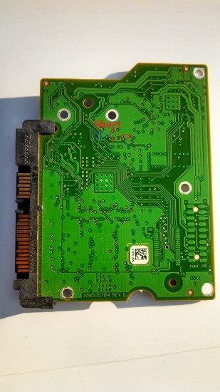

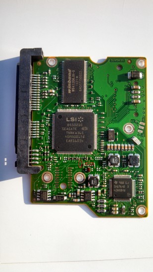

Re: "ST500DM002 busy
December 30th, 2015, 6:56
because :lol: mad about HDD. I got read right channel points on PCB . No matter if drive is going to be a brick or coming back as good storage, I just want to explore and want to learn data recovery .Hopefully the senior Drs will help me . thanks. i am attaching the images of patient HDD . guide me time to short points and till when ... thanks
PCB of patient drive
December 30th, 2015, 7:22
sorry ! the 2nd PCB points not correct,the correct point are bellow .guide me if i am still wrong
December 30th, 2015, 7:46
Short immediately after Second SPIN UP message and before (P) SATA Reset
Then Will reach No Host ...
then Ctr+Z
u will get F3 T>
December 30th, 2015, 8:14
Hi gps31, its not reaching at No Host...when i short it ,it comes on ready but not gaining F3T by pressing ctrl+Z. :?
December 30th, 2015, 8:35
When u see second SPINUP u have to short
u did at first spinup
in between
Spin Up
===> u have to SHORT here
(P) SATA Reset

If u shorted at correct time u will get
