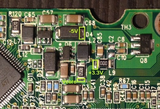

Hey,
I have this WD3000BB - IDE HDD. I have been keeping it for ages - it died on my like 7 years ago (just stopped turning on) and I meant, at some point, to rescue it.
That point is now :P
I looked around, and a possible cause is the PCB, since the HDD refuses to turn on, at all. I dismounted it and took some pictures. The area around R89 looks really tacky. Could anybody confirm my suspicion? Could it (also) be the TVS diode?

First thing to do is to clean up the contact points. They are the 18 brass connections to the top right of the PCB (as shown). Use an eraser, being careful not to hit any other electronic parts.
Re: WD3000BB - what exactly is wrong with the PCB?
January 29th, 2016, 16:21
Better to find a working Pcb with the same number on it....like 2060-70xxxx
And then swap the ic on U12.

Your PCB does not appear to have TVS diodes.
Can you measure the voltages at the -5V, +3.3V and Vcore test points?

Only thing I'd really bother checking is the zero ohm resistors such as L4 & L9 with a multimeter to be sure they haven't burned open and that you have continuity (if they have burned you can just jumper with a blob of solder. Otherwise, I'd just replace it. I really doubt an old PCB like this will cost much.

I am happy to report that with replacement PCB (I can only praise drHDD highly), the HDD now works :-)
September 11th, 2016, 13:56
Update: well, that did not go as planned.
What I did: used the board shipped by drhdd to see if the HDD boots and spins. It did.
Tried to resolder the U12 chip myself, as there are no services like this available where I live.
Aaaaand...I messed it up. Basically I now have the old U12 chip without the "legs" (six connectors that go to the board) and the new board is not functional either.
Is there anybody willing to provide a new board and resolder the U12 chip and ship it back to me? Please PM me here.
