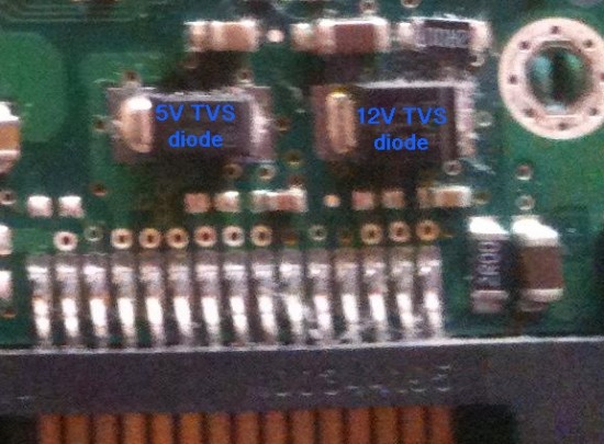

Look for shorted 5V TVS diodes.
http://www.users.on.net/~fzabkar/HDD/ST ... AS_TVS.jpg
Maxtor 6L200M0:
http://ep.yimg.com/ay/yhst-144375849714 ... oard-4.gif
Check CR203 on the Maxtor PCB (5V TVS diode). CR201 is the 12V diode.
The ST3500630AS diodes are shown in the attachment.

@radorn, what did you find when you measured the TVS diodes?
Why do think that linking an inductor is sufficient when the 5V TVS diode is obviously shorted?
Your Maxtor board differs from the one I found. Yours does not have any protection. That's why it burned.
If you cannot follow the instructions in my FAQ, then either send your drives to a DR shop, or purchase a replacement PCB, with firmware transfer, from a vendor such as hdd-parts.com. That will cost you around US$200.

Now I have checked your links a bit more. So, basically, you are saying that just removing the affected TVSs and bridging the burned inductors will allow the drive to run, though unprotected, assuming they succeded in protecting the rest of the PCB?
My repair attempt was done before posting here, as I assumed the smds were fuses. This is the first time I hear about TVS diodes.

The Maxtor , your best solution is to get a compatible pcb and a little luck .
Seagate is likely to be solved by following the advice of fzabkar (remove TVS damaged and bridge burned inductors).
Note that this process has its risks and could cause more damage.
En SEAGATE it is quite safe , but not always ....

Sorry for the late reply. I just now got arround to attempt this repair.
The Maxtor drive will have to wait for a new board, but so far I've got the 500GB drive and one of the 1TB Seagate drives (the one where I already had bridged the exploded inductors which I mistook for fuses) to work by just snipping out the 5V TVS diodes.
Thank you very much for your help, fzabkar and colanco.
