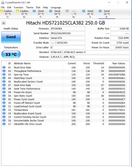

Hi All,
this is what i'v got from crystaldisk

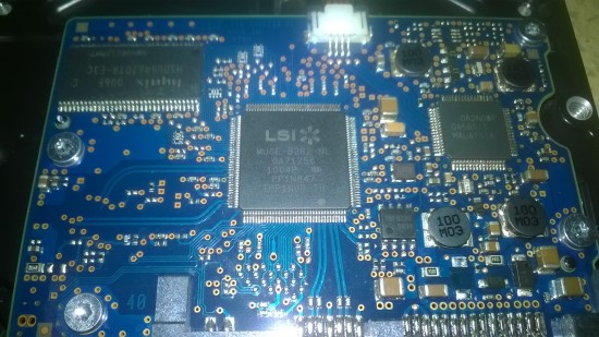

April 27th, 2016, 10:16
Hey, it looks like the drive are missing one of the TVS diode, does it impacting to the board power distribution ? can anyone tell me the equivalent for the replacement ?

April 27th, 2016, 10:38
Your drive is running, so likely not a PCB problem.

Hi labtech,
I already replace the missing TVS diode (googling and found the same code from another bad drive), problem still the same.

April 27th, 2016, 21:00
I had replacing four tiny capacitors on Tx - Rx SATA circuit, it's seems the problem has disappering, and i got more write/read speed also, from about 15 Mb/s to be 90+ Mb/s.
I'm now reformatting the drive, and re-copy as much as files into the drive.
Hope this is the permanent solution, and caused by weak caps.

A missing TVS diode would have made no difference to the drive's performance.
If those Tx/Rx capacitors were problematic, I can't understand why there were no UDMA CRC Error Counts in your SMART report. In fact there is no hint of any problem in the SMART data.
