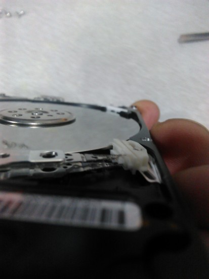

Hello!
Looks like this is not my lucky week. :D
I have received this drive as it is. Opened in another two companies before.

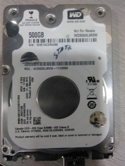

Hi!
The upper picture is NOT a WD5000LMVW-11CKRS0 drive, it looks like a Seagate F3 drive
Re: WD5000LMVW-11CKRS0
May 24th, 2016, 12:57
yes ,
this drive comes with 1 platter 2 heads ..
May 24th, 2016, 13:05
Sorry. :)

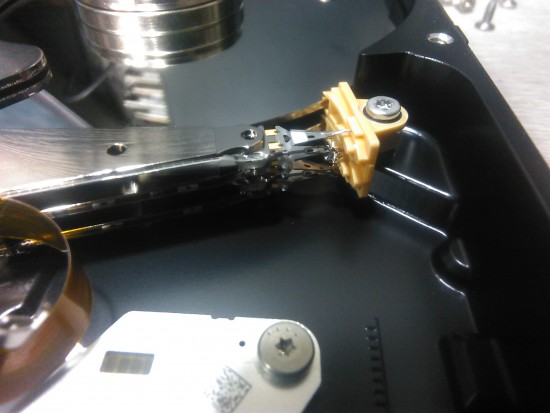

Update:
After replacing heads the drive ID's correctly with full model, FW, Capacity and SN.
In DE it shows partition NTFS and I can see the full structure of data but when imaging it images until first 168 MB then gives error. Backward copy gives the same error.
Soft reset, hard reset and reset power but also shows error.
Any suggestions?
Thanks in advance.
May 24th, 2016, 14:07
what about rom ?
fhe heads pass the teat ?
May 25th, 2016, 6:08
Im 99% sure this drive is self encrypting. Have you looked at the first sector?
Also your probably going to get a SED locked error in utility because this model blocks SA access.
You need to isolated heads, shift regions and remove the SED lock before you can do things like patching mod 02 etc.

You mentioned original ROM was missing. Have you regenerated mod 47 from SA?
Can you read the last sector of the drive?
Are you imaging in PIO mode?
May 25th, 2016, 10:34
I already accessed SA by shorting tv9 and tv10 then regenerated Rom by SA.
I guess heads are not fully matched.
May 25th, 2016, 10:50
Last sector gives error.
I tried imaging using udma and pio mode with no luck.
May 25th, 2016, 14:26
this drives .. normaly not encrypted
i think u replaced bad heads ... from bad donor
May 26th, 2016, 13:46
Case solved. Another fully matched donor did the job perfectly. :)
