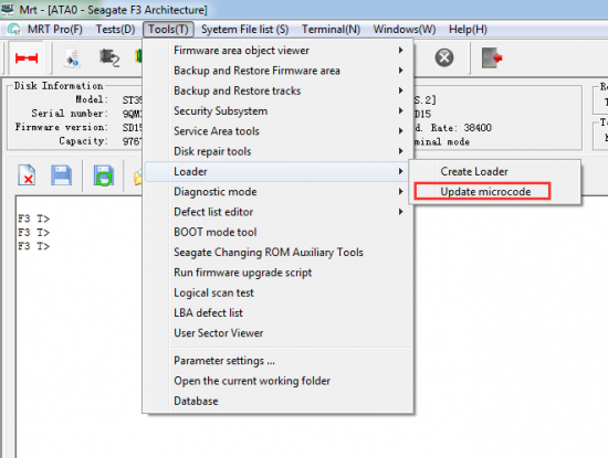

Hello, if the loader is created by a third-party tool, and in MRT Seagate utility, you can try to use those methods below:
The first one is to use the function of " Run Firmware Upgrade Script" in "Tools" function;
Then second way is to use the function of "Update microcode" in "Tools" function (Tools>>Loader>>Update microcode);
But I suggest you to use the first one, because it can support the universal loader form.
