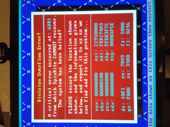

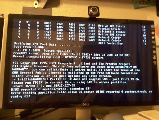

I tried running Spinrite software however it errors out. Attached is some pictures of the errors. I am at a loss on what to do next. I need the data off this drive so the solution needs to take this into consideration. Thanks

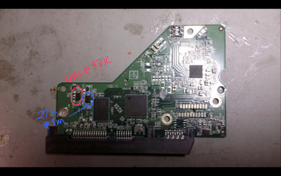

Can you upload a photo of the faulty PCB?
Can you measure the resistances of the two TVS diodes (D4 and D3)? If the drive suffered an overvoltage on the 5V supply, then this may have damaged the preamp.
Re: Western Digital HD barely alive
July 24th, 2016, 16:42
Picture attached. Ohm values on the image, i measured both polarities which is why there are 2 values.

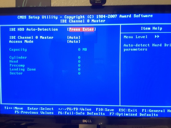

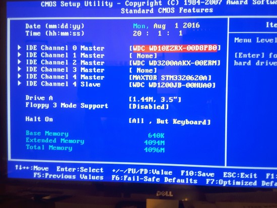

How exactly does the drive appear in BIOS? Model number? Capacity?
When you say "shuts down", do you mean "spins down" or do you mean that the drive stops responding?

BTW, SpinRite will only thrash your drive. It will recover nothing.

See attached screen shot, the drive is recognized but as you can see it only knows the model info, nothing more :(
"Shuts Down" = spins down
Bios Screen
Bios Screen

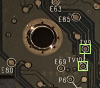

If you short test points TV9 and TV10 with tweezers, does the HDD still appear in BIOS with its correct model number? You only need to apply the short before applying power to the drive and until it stops clicking or spins down.
