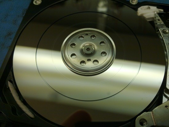

I would agree with Data Medics that firmware is a significant issue with Seagate drives, but the 3TB DM has other issues as well. From what I am able to gather, a significant portion of the people supporting the lawsuit have lost their data. ie they have already been to a data recovery company and the drive is classed as unrecoverable. These people want compensation from Seagate, while the others want their data recovered free. I have had three cases in the last few months with 3TB DM series drives that we could not recover. The client understandably asks if there is anything else they can do. So I personally sent their drives to Seagate to see what they say. All three came back as unrecoverable. Interestingly Seagate never give the reason for the failure as media damage......

August 1st, 2016, 18:43
Half of year I am coping data from this hdd. It was in Ontrack before and they told it's unrecoverable. I don't think they can't - they just don't want to (same as seagate in similar cases). They can't spend half of year and more for a case (if price for recovery not tens of thousand dollars).

August 2nd, 2016, 11:18
Price for this case is $2000.
