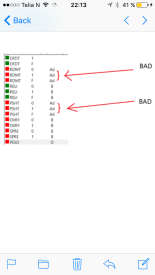

I have a little problem here.. after my 5yo daughter swiped with a magnet over macbook pro, the screen turned white and after restarting the machine a folder with question mark started flashing..
The biggest problem is that there is noone to blame but myself for not backing up/storing online work info and photos/videos of the first 5 yeats of my daughters life.. not doing that was simply over all measureable stupidity..
pc was delivered to a company which retrieves data, but i now received following information-
1. The main modules information of RDMT, PSHT are damaged, (without these modules
2. Inside modules have physically damaged sectors ( bad bloks), it is impossible to rewrite or correct them.

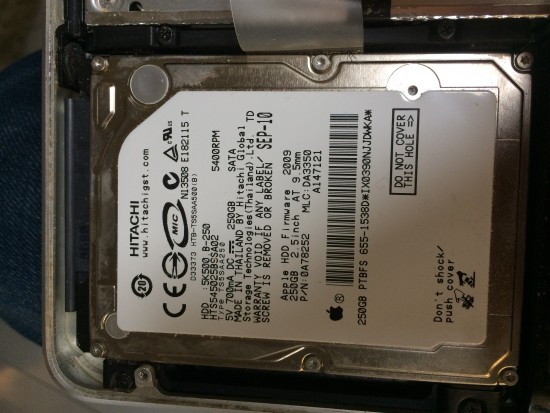

I've attached photo of hdd and printscreen of what theese guys sent me..
Would that be possible to get somebodys quallified oppinion about if its possible to do anything...?

As much as i understand, they swapped the disc(s) into something.. i am way too little competent to comment on wheather it has something to do with "head-swapping"..

If you have a tool like PC-3000 there may be some hope. If you can at least partially read both copies of PSHT, might be able to stitch together a sort of composite module. Then you can upload it back into RAM to get temporary translator going.

Data can be recovered even when the entire SA is gone.
