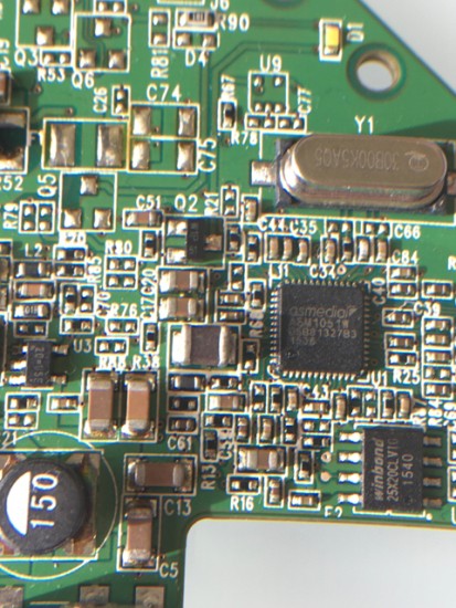

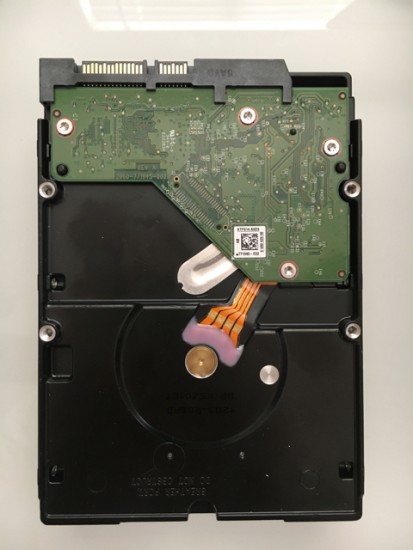

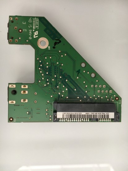

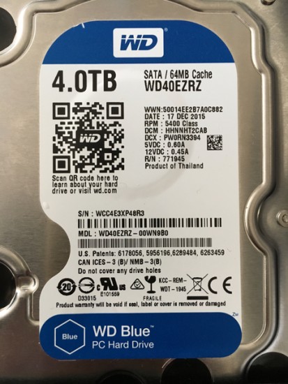

Here's yet another story of a failed Western Digital My Book 4 TB encryption board failure. My was less than a year old. I put it away in the closet while building my NAS for backups. Pulled it out a few months ago to transfer the data to my new 16 TB NAS and it was dead. Just the short blink of a white light and nothing! The hard drive didn't spin up. Like many before me, I pulled the case open and put the drive into an external enclosure and it powered up! Yay! This is when I realized, like many before me, something else was wrong - no data present. So... long story short, I've spent the last 2 months reading every blog, website and forum post on how these My Books and many other desktop and portable drives utilize hardware encryption - even if you don't set a password on your data! Argh!
I did a full drive scan and it has zero bad sectors
I've done a full drive image using DMDE - good god it took 14 hours to image the whole 4 TB!
I've tried using reallymine, but I can't figure out the syntax for pointing to the source image which is on my NAS. I know reallymine is setup properly and running because I can issue commands, read the help info and get errors when trying to decrypt.
I read all the posts by Roberto and his windows based decryption utility, but I think he's on vacation and I can't get the password to his utility archive.
So I'm back to reallymine, but can't figure out the Linux command line syntax for pointing to my NAS as the source. I have the folder shared publicly with full rights to everyone on my home network. I can see it and mount it in Linux, but reallymine doesn't like anything I've tried so far.
Could someone help with either the password for Roberto's utility or with the reallymine syntax?

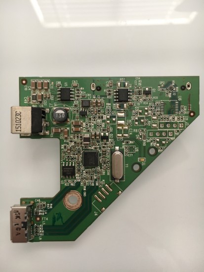

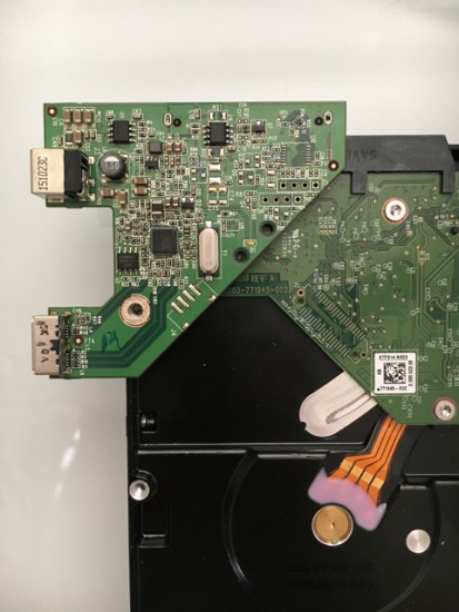

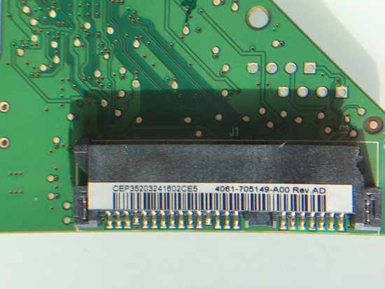

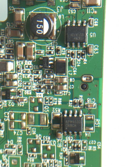

I'm posting images of my drive and encryption board in case its of use to anyone else.

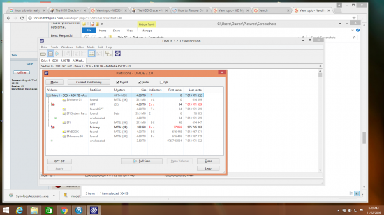

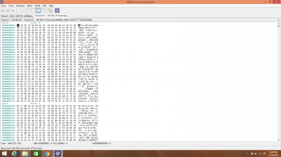

November 28th, 2016, 17:29
ncalsurfer wrote:In an external enclosure it reads as a 500GB mystery partition. Viewing through DMDE or any hex editor reveals unreadable characters.
Please show us sector 0 in hexadecimal mode.
The "500GB mystery partition" is what you would expect if the drive were originally in a 4Kn enclosure (4096-byte sector size) and is now in a 512e enclosure (512-byte sector size).
500GB x (4096 / 512) = 500GB x 8 = 4TB
This would suggest that the partition table is not encrypted.
November 28th, 2016, 18:10
Here is Sector 0
- Attachments
November 29th, 2016, 1:16
That certainly looks encrypted...
If the actual drive is fine, and you never actually set a password, then it should just be a matter of using the same encryption/decryption board as what was supplied. That does assume that it was the bridge board that was the problem.
November 29th, 2016, 4:07
Bort wrote:That certainly looks encrypted...
That would be great, except all 7 of the boards I have purchased off ebay and Amazon were also dead. I wish I knew how to trace and test these boards, would make my life a whole lot easier. It seems like guys are just tearing these out of old My Books and selling them as "new." Not a single one actually worked. pft.

Done and done already. All the encryption boards I purchased will not pass power to any hard drive they are connected to. The test drives I have used are all good, 100% perfect health. I even have several correct power adapters I have tested as well.

By the way, how are you trying these other boards when you say they will not pass power to the disks ?
I have one here ( Seagate, I think ) that will only energize the harddisk when it detects a usb cable connected to a computer. Without that cable, the HDD stays off.

fzabkar,
Here's the DMDE Partitions window screenshot. I'll try checking the usb/sata board too.

November 29th, 2016, 19:42
rogfanther,
Doh! I can't believe it! I've been banging my head against the wall thinking there's some guy out there stripping broken encryption boards and selling them on ebay and amazon! I bet all the ones I tried worked.
I just connected the single remaining non-broken encryption board to my hard drive and voila! I have all my contents!
I still considering running reallymine once I get my data off the hard drive to see how it works. But thank goodness I have my data and thanks to everyone on this forum! I have learned so much the last few months!
