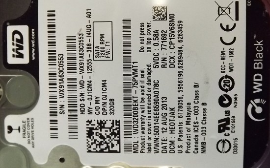

Since the failure of the WD3200BEKT-75PVMT1 3 days ago
I am concerned with the subject.
Error: Bios finds the disk with 0MB
FW: T1
Data is not important, but the disk would like to get run.
Have read much but not further.
What do I need for software?
Do I need a new FW or what is deleted?
Many thanks in advance!

Hi! Does the HDD Id' s properly on BIOS? Does the HDD coninue spinning after boot? If the answer is yes you may probably have a firmware problem. If it is not the problem seems to be in the heads.

The BIOS is only 0MB. No ID, no type

Does the hdd spin?

Engine turns, one click is to be heard
WD Marvel I test in the WE after new Year's Eve
