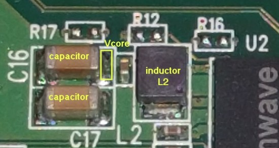

Upload a photo of your PCB. Sometimes there is a simple DIY fix.

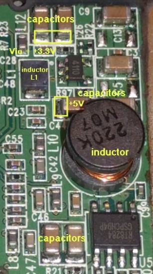

Sorry for the slow upload, the holiday is getting to me!
@data medics, I did call those guys and they were helpful - but unfortunately they have flat rate pricing which is still kind of high.
They did mention they thought I could use any version of the board, provided it has the same Symwave chip. Any thoughts? I've seen some Rev AB and Rev AG on Ebay/Amazon I could try
Now is the 4060-705089-001 just the USB 2.0 version of what I have?
Thanks guys

@khans011, if you have a multimeter, measure the Vio, Vcore and +5V test points.
