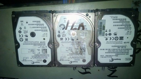

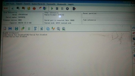

i have some drives showing port lock disable on terminal
and showing total capacity 0.3gb.
family Casy and crockett 5400.4
is there any solution.

FDE means Full-disk encryption . The only solution - get the key.
