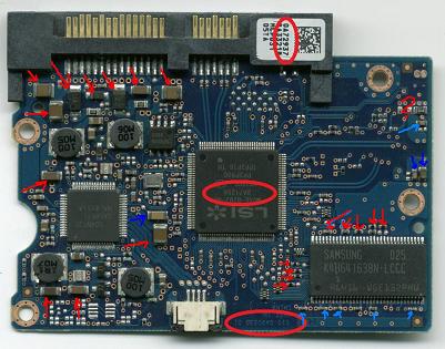

Measure the resistance of the two TVS diodes ("14" and "Z2") and the two R100 (?) resistors near the SATA power connector at the top left corner.

fzabkar wrote:Measure the resistance of the two TVS diodes ("14" and "Z2") and the two R100 (?) resistors near the SATA power connector at the top left corner.
https://sep.yimg.com/ay/yhst-1443758497 ... 120-13.gif
I checked all diodes. I signed with red cursor both-way diodes, and with blue - one way diodes. Question mark - I don't know what is that.
Re: What happened to my hdd?
July 23rd, 2017, 16:54
Your image is not helpful.
What are the resistances of the TVS diodes and "fuses"?
http://www.users.on.net/~fzabkar/HDD/HD ... EEPROM.jpg
Use the 200 ohms range of your meter.

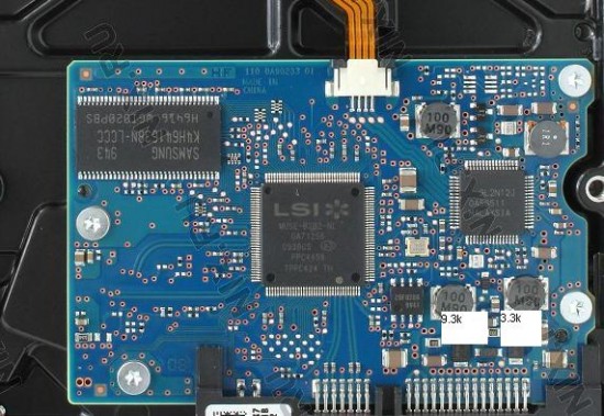

TVS diodes with 200 ohms doesn't work. It work only when I switch to diode mode. Also when I swith the meter to 20k ohms 5V TVS Diode shows something like 9.88, and with 200 Ohms doesn't show anything. I don't understant what that means.
July 24th, 2017, 8:11
Now I rechecked. Tvs diode on the left showed 9.3k ohm and on the right 3.3k ohm
July 24th, 2017, 18:57
With the meter in diode mode, does both TVS show continuity in one direction, and open circuit in another ?

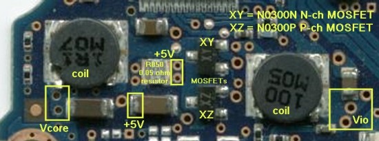

Measure the voltages at Vcore, Vio and +5V.
Here is a similar Vcore circuit from a different Hitachi model:
                  +5V
                  | | R100      current sense
                  | | 0.1 ohm   resistor
    CS |           | N0300P
.--------.    XZ  | P-ch MOSFET
| hi-drv |     ||->    1uH
|        |-----||-+   inductor
| motor  |        |   ___
|control |        +---UUU---+-------+---------+--o Vcore
|        |     ||-+   1R0  ---     .-.        |
| lo-drv |     ||-<        ---     | | Rfb1   |
|        |-----||-+         | Cout | |       --- Ccomp
'--------'   XY   | N0300N  |      '-'       ---
Comp|  |FB         |  N-ch   |       |_____.   |_________.
    |  |           | MOSFET  |       |     |   |         |
    |  |           |         |      | |    |  | | Rcomp  |
    |  |           |         |  Rfb2 |     |   |         |
    |  |                    GND            |  GND        |
    |  |           feedback                |             |
    |            compensation                            |
