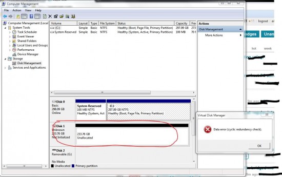

Hi everyone!
I have a big problem with my Toshiba MQ01ABU032W 2.5" sata hard drive 320Go
more information plz visite : https://www.hdsentinel.com/storageinfo_ ... Q01ABU032W
or : https://toshiba.semicon-storage.com/ap- ... uxxxw.html
the problem is when i'm traing to format my HDD i have the message OF ata Error (Cyclic Redundancy Check)!
What is the problem that you think it might be? Please help!!
Thanks in advance ;)

Cyclic Redundancy Check error is caused by bad SATA cable or bad connection. Try repluging the SATA cable (on both sides) and changing it with a good one.
Re: How to Fix Data Error (Cyclic Redundancy Check)!
September 10th, 2017, 5:20
Thanks BGman, For the advice but i changed the SATA cable but i still have the same problem
September 10th, 2017, 6:30
Give us more details about the program you are using, the format you are trying to do, what is the exact message you are receiving.

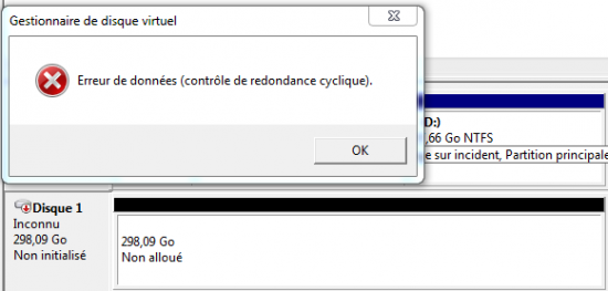

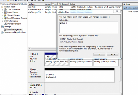

okey, i use windows 32 bits to format but when i insialise the HDD whit MBR or GPT i recive the message of Data Error (Cyclic Redundancy Check) this is the picture
September 10th, 2017, 15:08
The drive is not being detected properly.
    238.47 gibibytes = 256.055 gigabytes
What does CrystalDiskInfo report?

Hi guys, and thanks for the help , MRs fzabkar, CrystalDiskInfo report givs me inconnu

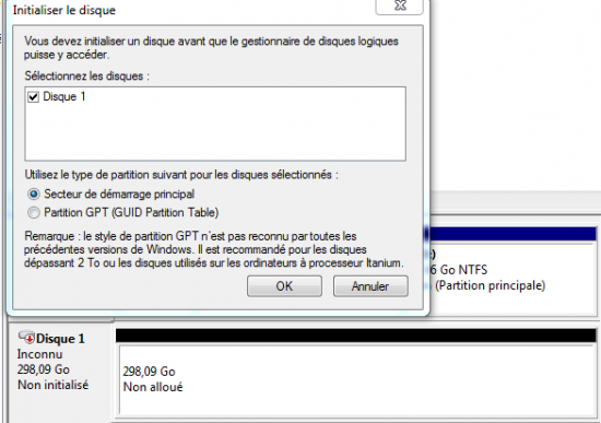

finaly this is the msg what i recerved
in this and when i want to inisialise my HDD they give me too methode MRT or GPT in each choise they give me CRC
