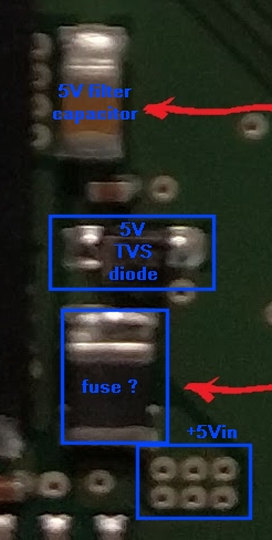

I have a samsung drive I pulled from an enclosure. It is not spinning at all. My limited expertise told me to check if it has a blown tvs diode. When I check for continuity between the 5 volt and ground I do not get any. To me that means the tvs diode is good. Actually I am not sure this drive even has one. I labeled two parts "1" and "2" by the power connector, Here is what I know
-no continuity or an ohm reading of 1 when I put my meter on bother sides of part "2"
-one side of part "2" goes to ground and the other side goes to the 5 volt
-part "1" has continuity and both sides go to the 5 volt
Any help an giving me direction would be great
Does this drive have a tvs diode? If I was to guess, I would say no.

Measure Vcore and Vio.
Does the drive attempt to spin up? Can you hear any sound, however faint?
Re: samsung hm100ui not spinning
October 12th, 2017, 18:09
no sound at all. I am embarrassed, I did not even barely notice that small tvs diode. How do I measure the vcore and vio?
I have an ohm reading of about .5ohm between vcore and 5volt and also the same with vio

Measure the voltages between ground and each of Vcore and Vio.
October 12th, 2017, 18:45
fzabkar wrote:Measure the voltages between ground and each of Vcore and Vio.
vcore = 2.5
vio = 1
October 12th, 2017, 18:56
Those voltages are OK.
Try to obtain a terminal log.
How to connect a terminal adaptor on a Samsung drive ?
http://www.hddoracle.com/viewtopic.php?f=116&t=189
BTW, did you test the drive in a PC? Some drives are configured to power up in standby (PUIS). Also, some enclosures won't spin up a drive unless they detect a USB host.
