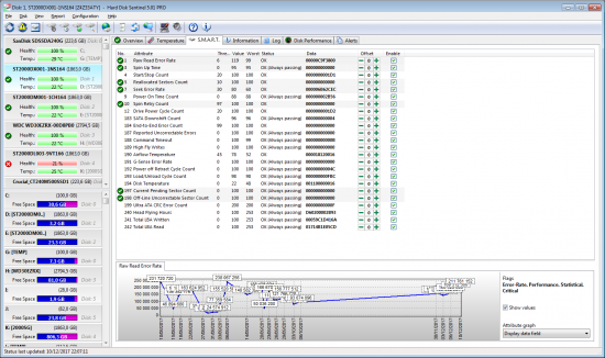

Is this SMART normal for a new portable disk.
Crystal disk info
HD tune
HD sentinel
HD tune read test
I am worried about that raw red error rate 65 - 84, that ok?
I run Seatools long and short generic test, test passes without problem.
Seagate Drive Settings program won`t detect anything in Win10 so I can`t check with that.

December 10th, 2017, 17:21
– People here will most probably tell you (if they're in the mood, or if you
insist a bit) that Seagate HDDs are crap (it almost seems like it's insulting to even ask if it can be safe to use one !
– Otherwise, I would say that if three reputed softwares report that particular unit as healthy, then it can be considered healthy. All my Seagate HDDs have crazy numbers in the “Raw read error rate” field (see attached image), I don't know why but it doesn't seem to be of particular concern. It may or may not be related to that statement I read on
this forum recently :
The flying height of today's drives must be a lot lower than in those older models, and today's higher track density would be placing much greater demands on the servo system and on the motor bearing. To get an idea of the progression in technology, it might be worth following the changes in the Hardware ECC Recovered SMART attribute in Seagate's models. AFAICT, the normalised value for this attribute has steadily declined with newer models, to the point that Seagate no longer appears to report it. ISTM that HDDs are nowadays digging data out of noise.

As for your concerns in respect of the Read Error Rate attribute, I would compare your SMART data against other examples from the same model. Perhaps your results are normal?

SeaChest is telling you that there are no read errors.
The reason I say that you would probably be happier with CrystalDiskInfo is that it is a point-and-click program. SeaChest is far more useful, but it requires that you be comfortable with the command line.
BTW, CrystalDiskInfo should identify the model number of the drive inside the enclosure. Use that model number to search for SMART reports from other Internet users.
Also, be aware that you can redirect the output of any SeaChest command to a log file.
eg ...
SeaChest_SMART -d PD3 --smartAttributes analyzed > logfile.txt
CrystalDiskInfo can also write its reports to a text file.
