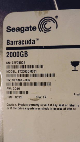

February 6th, 2018, 10:24
This is my patient hdd
- Attachments
- Patient

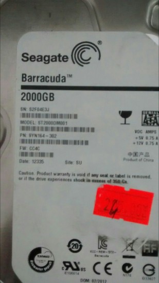

February 6th, 2018, 10:31
Thia what can i find for donor.
Model no match 2. and 3. number of S/N is match which means plates and heads number ok. Should i buy it? İs worth taking the risk.

February 6th, 2018, 16:04
this is definitely not compatible for donor.

February 8th, 2018, 16:04
It might be compatible, but wouldn't be my first choice of drives to try.
February 8th, 2018, 18:21
pcimage wrote:hyuce wrote:this is definitely not compatible for donor.
Really?
SN of the patient drive : Z2F
I do not think that the models in the picture are compatible. Donor drive SN start as S2F
I do not think it will be the right choice for me.
am i wrong?

February 11th, 2018, 0:57
preamp vendor is different.
May 11th, 2018, 6:01
I've just worked on one of these. There was decent compatibility between S2F0 and Z2F0 drives. A good recovery was made. It was not necessary to import the head-adaptives into the the ROM.
The physical head map on these disks are 1,2,3,4,5.
For reference, the patient HDD was:
ST2000DM001
SN: S2F0....
9YN164-500
CC4B
SU
Donor was:
ST2000DM001
SN: Z2F0....
9YN164-302
CC4C
TK
I hope this helps.
