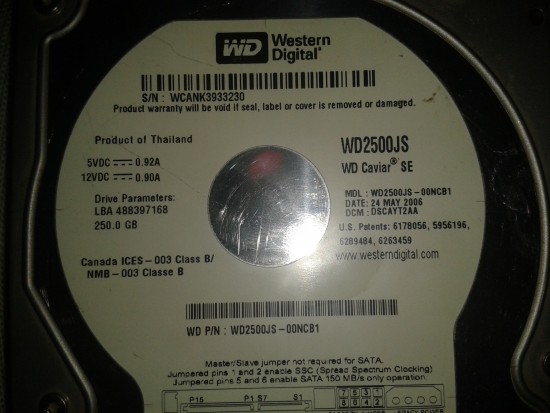

I want firmware
S/N:WCANK3933230
MDL:WD25000JS-00NCB1
DATE:24 MAY 2006
DCM:DSCAYT2AA
LBA 488397168

Client Clear firmware
What is the family of the drive
PCB :13335
- Attachments
February 22nd, 2018, 20:52
I do hope that you do not need to recover the data on this one:No Did not matter
Client used something like WDR as well to clear firmware ?Yeah That's what happened
You can't just write firmware from other drive if you need the data:There is no
What do you see with WDR ? Does it enumerate modules at all ?
WDC ROM MODEL-HAWK----- FW:02.01C02 SN:WDC-ROM SN_ XYZ---- (ROYL selected) port 0x1F0
Logical: Cyls 15528, Heads 16, Sectors 63, LBA 15651217, 8Gb
Controller Buffer Size: 8192Kb
Family: Hawk

Spildit wrote:So .... did you manage to repair your client drive ?
Yes Done
February 25th, 2018, 21:10
Spildit wrote:Very cool !!!
Can you tell use how did you manage to fix the drive ?
Let me guess, you did write that "new" firmware from the database back to the drive with WDR and you have written new ROM as well and now drive is working just fine ?
