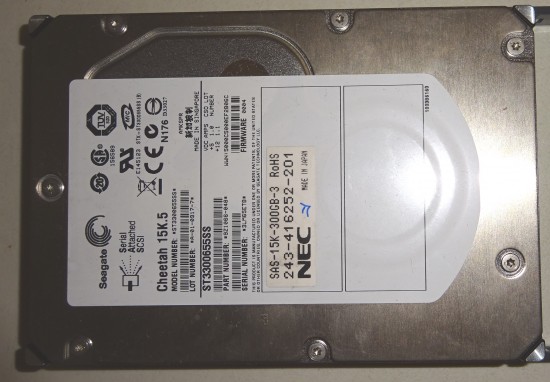

They may be formatted to non standard bps can you post a photo of the label on one of the drives? Also, what model is your sas controller ?
Are you familiar with Linux?
Re: Need Help For Hard Drive Seagate Cheetah 15k.5 ST3300655
March 12th, 2018, 14:08
scratchy wrote:They may be formatted to non standard bps can you post a photo of the label on one of the drives? Also, what model is your sas controller ?
This is the label of one disks, they are all identics.
As said before my controller DELL model UCS-61 SAS 6/ir, mounted on a classic motherboard Abit Quad IX38
Please help me , I have more than 100 disks to save!

It could be just a sector size issue. Perhaps they are from a SAN running 520-byte sectors instead of 512. If so, you can likely re-format them to 512 using SG3_Utils and the sg_format command.
I'd check that before trying to change the FW version or anything like that.
