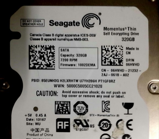

the drive read its's details ok
juluis1 family
Model : ST320LT009-9WC142 , Firmware : 1002DEMA
termial lock : the output is
(1Ah)-TCG Serial Port Disabled
can't access user data and can't even take resources . i don't think rosewood way can word with this .
any advises please ?

yes it's self encrypted drive
what should i do?
Re: seagate juluis1 320 with terminal lock
March 11th, 2018, 11:59
my client said no password , but the drive itself is encrypted on it's label as shown in pic
i try rosewood rom patch but not worked . still the same
can't take resources and can't access user area

In Russia FDE is forbidden (so no experience), but why not try to import the adaptive (rap,sap,..) (in simple Julius), boot under Ldr and subtract the module with a password.

my customer insist that there was't any password on the drive or even on bios setup .i will try Mr.Moltke suggestion .
April 1st, 2018, 22:23
Tawfeek wrote:i will try Mr.Moltke suggestion .
Unlikely would work
AFAIR these drives through exception (even with non-SED ROM) once they see SED overlay on platters
April 1st, 2018, 22:26
if you cannot access user data it could be because
1. damaged SA, in this case unlocking and fixing the drive would help
2. errors in UA
3. TCG-locked UA, you would have to have user password and original laptop to unlock it, no password bypass on these drives
AFAIK PC3K can't unlock it
But several people on this forum can, if they're interested, I'm sure they'll find you
April 2nd, 2018, 11:51
Doomer wrote:if you cannot access user data it could be because
2. errors in UA
no 2 is correct totally , i can't access UA
my client ensure that there was not any kind of password
for sorry non of them looks interested , No one find me out :( , ACE support Asked for ROM and still nothing new , waiting there Developer
