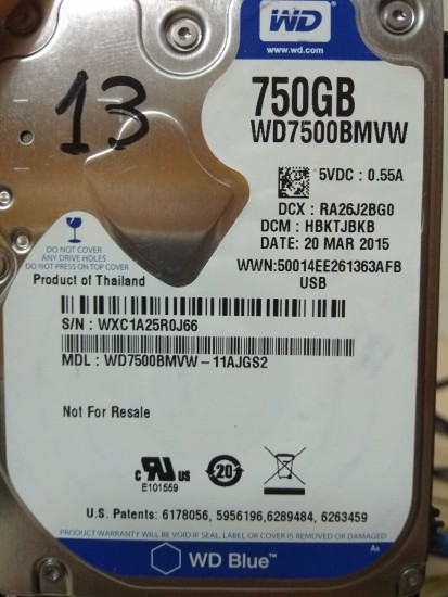

I have the hard drive that I have put in the photo.
I do not know the firmware that it carries nor the family of hard disk that it is.
I have the mrtlab and it does not detect it with a sata card.
I changed the heads and they work well.
Can somebody help me. Thank you.
Image of HDD

I do not know which HDD family to select, it does not detect anything but the controller is fine.
Re: Problem wd7500bmvw-11ajgs2
July 1st, 2018, 8:36
Isolate the pcb, let it come RDY, start the utility in kernel mode and you can see the family. Block SA access. Restate the drive, us a leader. Start utility in normal mode and see if you can get SA access to solve issues.
July 1st, 2018, 8:37
It's FBLITE family.

FBLITE with 4 heads with one isolated head.
@OP: what was the initial problem?
July 1st, 2018, 14:31
Thank you very much to all for your help, with which I have verified that the family is fblite as you have told me and I have learned a very important thing isolating the motherboard and detecting in kernel mode the family.

The initial problem of the disc was a blow while it worked. The heads are fine, I've tried them on another disk and they work, but the plates are a little marked just outside.

The problem is that when trying to detect the disk, it stays in busy and when trying to load a loader it fails and stays in busy. I will think about something, to try to have access to the SA, which at the moment I have not been able to do so.
Indeed, some damaged areas have, because at the edge of the upper plate the plate is scratched.
