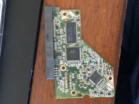

So my imac wouldt turn on. I pressed power button a few times and heard a pop and then smelt burnt smell. Unplugged it and let it sit.
Now im trying to recover data. I removed hard drive and got a SATA cable. When I plug it in the light flashes on then off and that is it nothing. I cant hear anything.
The model number is WD1001fals-403AA0
Not sure what to do from here?
I have seen that i might be able to replae the board on the HD but not sure?
July 11th, 2018, 14:54
If you hear absolutely nothing than it is possible that the board may be fried. Can you take a picture of the component side of the PCB. You will need a Torx T8 to take off the board.
Unfortunately you cannot just swap the board from another like drive and have it work. ( unless you get very lucky it is the same rom version). If it is a bad board you would need to swap the rom information over to a donor board.
But it is possible that this PCB has a TVS that has fried and it could be an easy fix to get the drive up to recover your data, but not for continued use.

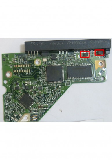

July 11th, 2018, 14:55
There's a chance that the issue is just a blown TVS diode on the drive. That model typically has PCB number 2060-774640 which has TVS diodes on both the 5V and 12V rails.
Get yourself a multimeter and check for resistance across these two components. If either one reads dead short measured in both directions, it can simply be removed.
Just be sure you're running on a clean power supply, preferably plugged into a UPS battery, since removing that will expose other components to power surge damage.

July 11th, 2018, 15:00
Thanks DM, I could not find one handy to take a picture and show. Usually the one I see damaged the most is the one on the far right at the edge of the PCB

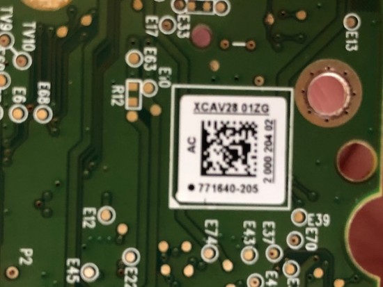

July 11th, 2018, 16:20
Ok here is a picture. Also I tested resistance and it works oneway but not the other is that correct? Or am I doing something wrong?
- Attachments
July 11th, 2018, 17:03
@SSStang, are you saying that both diodes test the same way?
Can you give proper resistance readings for the diodes and zero-ohm resistors?
