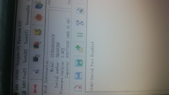

Hi I have seagate 3.5" classic series 500gb hard drive. Puis enabled on it. Tried MRT and HDAT2 for disabling. While trying to disable PUIS by MRT it gives error and do nothing. And after power off on the drive still goes to same condition i.e does not spin.

Patient drive serial port disabled.not working with terminal.

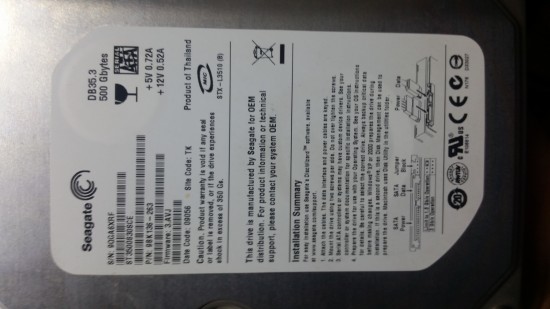

I can't find any document which explicitly states that DB35.3 drives are SEDs. However, these drives incorporate Seagate's DriveTrust Technology which does provide for full disk encryption.

ISTM that the OP's failure to spin up the PUIS enabled drive would suggest that a "trusted" VSC is required to do this.

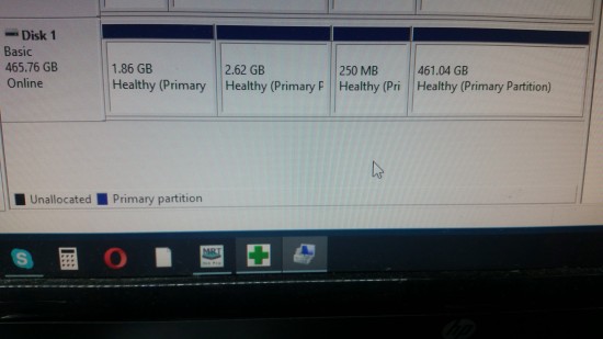

Yes you are right fzabkar. Its not SED. Seems that its full disk encryption with seagate drive trust technology. Below is the partition detail in image.

Sorry, I was confused. I thought that your were unable to get your drive to spin up. Now it appears that standard ATA commands (Set Features or Read/Write Sector) will spin up the drive, it's just that you cannot disable PUIS using standard ATA methods.
Your latest screenshot suggests that you have no problem with data access once your drive spins up, so it is not "locked" in that sense. Therefore ISTM that you need to locate the PUIS flag bit/byte in your ROM and flip it. To this end I would obtain an "unlocked" DB35.3 drive and compare its ROM images before and after enabling PUIS.

yes initially drive is not spin up but when it connects to terminal it works fine until we power off the drive. After power on drive goes to same condition, while disabling the PUIS feature it gives error. Due to "serial port disable" none of the operation can done,also I can not Read the Rom of this locked drive
