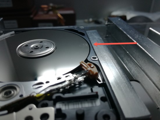

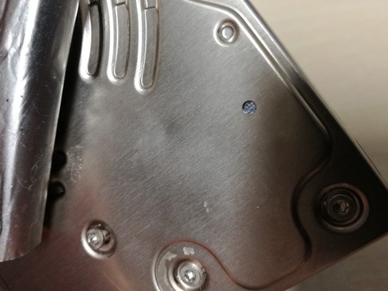

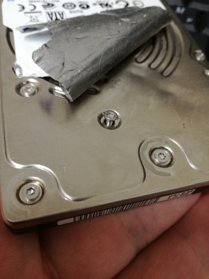

Hey guys, today I have a total horror case on my table. The HDD came to my lab not even with the head screw screwed in completely. The screws are looking like some one was using a flat screwdriver to undo them. And on the top surface I saw two fingerprints and a fine scratch on the surface about 7mm from the outer side. Normally I would reject the case, but the owner of this drive want to give a try, so she sent a donor drive in, that I can use. So I'd like to give it a try.
My first problem is, how can I get rid of the fingerprints? Can I just use clean room wipes to wipe the fingerprints off? Another Option would be these Lens Pens.

I think Lens Pens changed their construction from a black felt-type element to something lighter that makes things worse. I don't recommend them anymore.
Re: How can I clean fingerprints from the top platter?
August 6th, 2018, 16:44
jono-ats wrote:I think Lens Pens changed their construction from a black felt-type element to something lighter that makes things worse. I don't recommend them anymore.
So what's a better option? Clean room wipes?
August 7th, 2018, 12:32
I've used these combined with 100% IPA a few times to clean fingerprints off: https://www.soscleanroom.com/product/sw ... S0QAvD_BwE
Just be prepared that even with multiple thorough cleanings you may still have to remove the heads and clean the sliders a few times.
