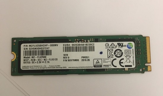

Any one tried working converter for Samsung mz-flv2560 comes out of Microsoft surface 2 . i have may converters for m2 . but all it's socket are shorter about 2 mm than the device

aren't these mSATA? not M.2? pretty sure they are standard
September 16th, 2018, 9:28
It's a Form Factor M.2 2280 NVMe...some ordinary adapters won't take them.
Check if your motherboard has a M.2 slot...if so, it will probably fit.

mr_spokk wrote:It's a Form Factor M.2 2280 NVMe...some ordinary adapters won't take them.
thanks for replay
the microsoft surface main pcb is died .and even ACE m.2 adapter is not fit to the drive . the 2mm larger than the adapter soket

HaQue wrote:aren't these mSATA? not M.2? pretty sure they are standard
i think it's m.2 NGFF but not sure . i attached the drive picture .

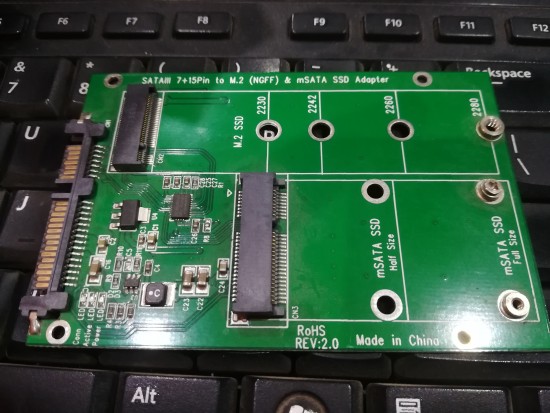

here is one, it should be fine.
have bought this and 10 more from China.
will search the contact info.

Are you sure it is a surface 2? even surface 3 had mSATA. I am thinking a surface Pro 4..?

HaQue wrote:Are you sure it is a surface 2? even surface 3 had mSATA. I am thinking a surface Pro 4..?
that's what customer said . he just bring us the SSD to take the data

All my Google searches for PM951 or MZ-FLV2560 identify the SSD as PCIe x4.

if that is the SSD, datecode of 2016 implies that maybe not a surface 2. they stopped production in 2015 of them.
Model :MZFLV256HCHP
Capacity(GB) : 256GB
Interface Type: M.2 NGFF PCIe x4
also:
and it would be the M.2 with "M" key in the slot
https://www.pugetsystems.com/labs/articles/Overview-of-M-2-SSDs-586/

MindMergepk wrote:here is one, it should be fine.
This adapter will
never work with this model
