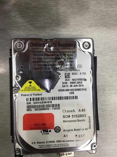

A customer give me that drive today.
The top side has a scratches (rings).
The question is: is it worth a try or it would be unrecoverable?

I personally, I would try. I think the possibilities are low.
If the client is worth part of the data, if they are photos for example or many documents, it is always worth trying.
It will always be of experience.
Greetings.
September 26th, 2018, 13:21

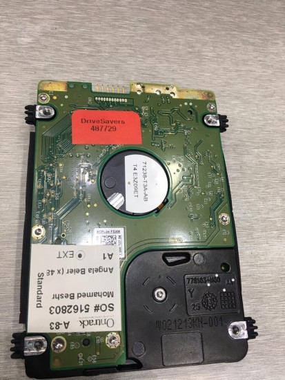

That HDD has been around the block
Ontrack and DriveSavers.
September 26th, 2018, 14:06
It depends on the state of the other surfaces, we have made many reasonable recoveries from drives with ruined top surface.
September 26th, 2018, 14:08
Blizzard wrote:That HDD has been around the block
One of two scenarios for this..
1. Neither company could recover it.
2. Client didn’t like the prices he was given, which are likely to be pretty high.
September 26th, 2018, 14:13
The customer said that he accepted the price.
But they told him that it's unrecoverable.

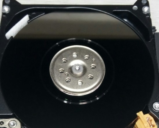

October 15th, 2018, 8:52
Fortunately, I could recover 57GB (working pics) out of 72GB (total folder space) with head 7 physically isolated.
I am very lucky that was the only folder the customer was needed and the rest was movies and programs
October 15th, 2018, 16:20
Lucky indeed, but still remarkable after two “big” companies declared it a lost cause... It goes to show that the “little” ones are sometimes better performers !
So in a case like this nothing at all could be recovered from the damaged platter ? Was it scratched all over or just in one spot ?

abolibibelot wrote:Lucky indeed, but still remarkable after two “big” companies declared it a lost cause... It goes to show that the “little” ones are sometimes better performers !
When I get to the office tomorrow I will post a picture of the (ring Scratches).

unknown wrote:Fortunately, I could recover 57GB (working pics) out of 72GB (total folder space) with head 7 physically isolated.
Congrats for this case!
....but i have a question.
How did you phisically isolated head 7 ? What was your trick? Please share us!

Here's the picture:
