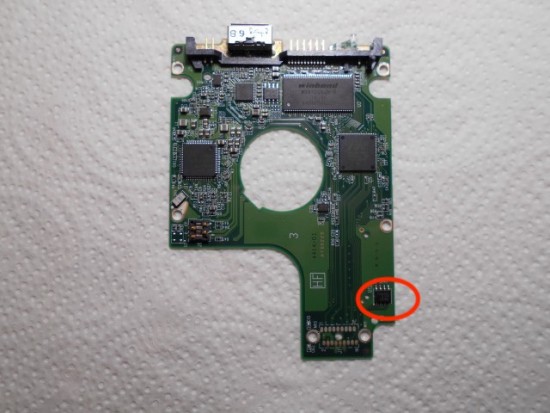

October 6th, 2018, 14:06
I realized the pictures of the pcb removed for the usb pins identifying:
https://ibb.co/moj41z
https://ibb.co/ifEXoe
https://ibb.co/b0LcMz
https://ibb.co/nLZREK
https://ibb.co/n50iuK
https://ibb.co/nBPREK

Re: Usb pin out
October 6th, 2018, 14:49
Buy a pcb 771960...and move marked komponent.

October 7th, 2018, 9:34
So I would prepare a spare usb cable and solder the four connections as indicated in the edited photo.

October 9th, 2018, 7:58
I soldering many times pins but the soldering did not hold and pin with a part of the card board snapped.
Pcb seems to be a very poor quality.
The picture :
https://ibb.co/nJkLyp
I think the pcb is out
A short-circuit is now present between the 2 pins D+ and D-. :(
How to solve this problem ?
Re: Usb pin out
October 9th, 2018, 14:36
Sorry to say but your soldering skills and probably your equipment is not up to the job!
To remove the short might be difficult as it appears you have poked the two little solder pads to death.
It might be possible to remove the short circuit and connect to the other side of the pcb?
Now a really easy job has been made harder and probably your best move is to buy in a new pcb and swap the chip as suggested by mr_spokk.
My best advice is to get somebody with the required knowledge, tools and skills to do it for you.
