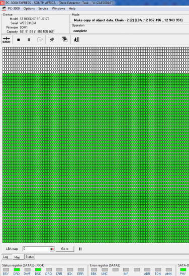

Seagate ST1000LX015
After patching and writing ROM to drive, drive stays BSY, error in terminal: Verify ALF FW Signature failed

Hi Mike, thanks for the reply. I'm managing to work with it, albeit slowly, without patching ROM, so I'll see how I go. Cheers.
Re: Rosewood SSHD ROM patch: Verify ALF FW Signature failed
October 11th, 2018, 8:42
Managed to get a good recovery of his user profile after a bit of fiddling with timeouts etc. Hoping for a solution for the rest of us plebs to patching these ROMs.
