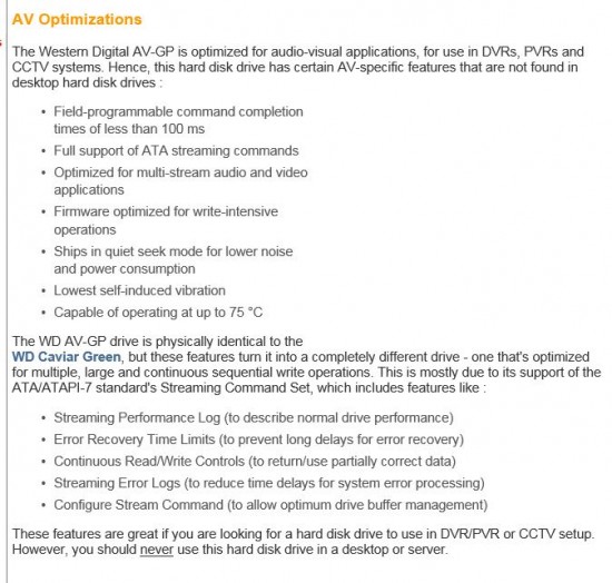

AV hdds (video) are having specific firmware optimized for continuous writing , such drives have low rpm & low read speed.
ecc error correct mechanisam is altogether removed .
These disks are not supposed to be used in desktop pc applications.

posidon wrote:ecc error correct mechanisam is altogether removed
https://www.seagate.com/files/www-content/product-content/skyhawk/files/image-perfect-smart-safe-solution-cb4-tp694-1-1701us.pdfBuilt In Powerful Error Correction Code
Powerful error correction and data recovery algorithms are built in to ImagePerfect, providing the highest assurance against video frame losses while intensive multiple video streams are recording. Its high speed on-the-fly error correction coding1 also helps to ensure no video freeze frames during live playback. These significantly reduce the chances of unrecoverable data error or video intermission in surveillance applications.
1 Higher data error (sector/ bits) correction on-the-fly will reduce the number of drive retries.
October 22nd, 2018, 9:33
Hi
Pls. note "Powerful Error Correction " code is specific to writing video streams only.
There is technical difference between 2 ( ECC error correction for normal Desktop / enterprise disks and Error correction implemented in video hard disks.
Don't mix both things as they are different optimized for particular type of disk only.
Hope it is clear now.

posidon wrote:Pls. note "Powerful Error Correction " code is specific to writing video streams only.
Error correction is
not limited to video streams. A PVR needs to be able to write and read file system information in addition to AV data. Regular ATA Read/Write Sector commands are used for critical data while the ATA Streaming Command set is used for AV data.
