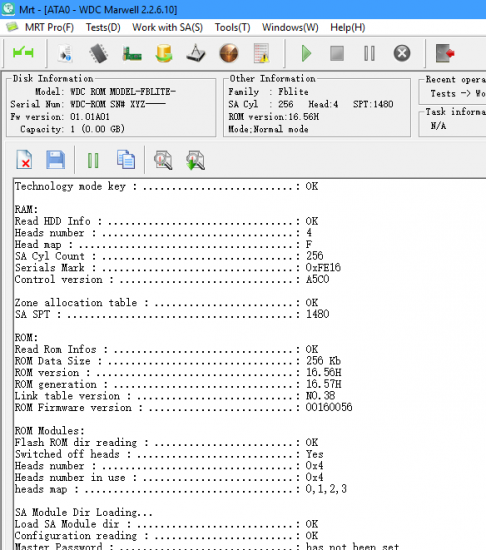

Hi i have this drive and can not acces data, what is instruction of hot swap ?
November 13th, 2018, 4:26
There is none.
ROM module 4F is unique, so you can't hotswap them.
November 13th, 2018, 4:43
northwind wrote:There is none.
Are u sure ? so whats the other option for data recovery ? this is USB drive i changed board to SATA
In this drive i cant access data and without disable 411 I cant access to modules
I try to seek loader so module 411 and 1B successfully write but 11 with error and not helping.
this is the pic after disable 411

1. It's probably not heads problem because the drive can read SA
2. You didn't write why you cannot access data. And this is the most important part right now
3. Most likely the heads test after a hotswap won't work because adaptives in 4F won't match. Drives usually don't write with non-original adaptives

So I manage to load ldr to drive somehow
, and i don't now how exactly I do that, but drive now functionally normal. thanks guys for guides.

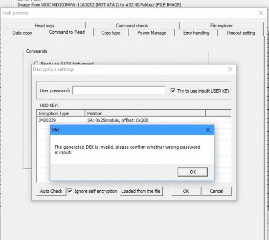

hi again when i try to decrypt in mrt this happened, I asked costumer and he say he didnt set password on hard, could it be for damaged module ?
