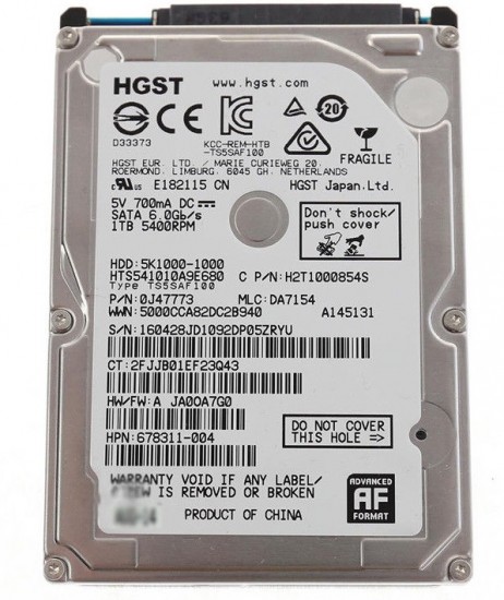

I've got one of these 2.5 5400rpm 1TB HGST HDDs:
HGST HDD 5K1000-1000 HTS541010A9E680 FW:560
Unfortunately the SATA speed restriction is not supported in FTOOL.
I would like to limit the auto-negotiated speeds to SATAII, instead of the current SATAIII as my 2011 Early Macbook Pro struggles with SATAIII in the optibay adapter (known issue https://forums.macrumors.com/threads/1tb-hdd-early-2011-macbook-pro.1584023/).

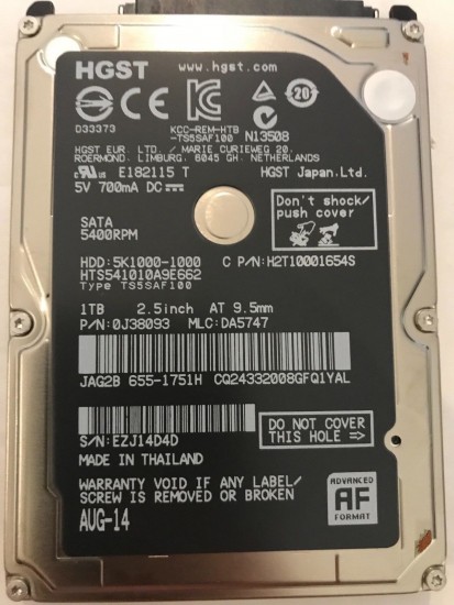

Since there is a reduced speed version of this under HTS541010A9E662 to SATAII, is there a way to restrict the controller on mine?
If so, please could you advise what equipment I would need to perform the changes necessary?

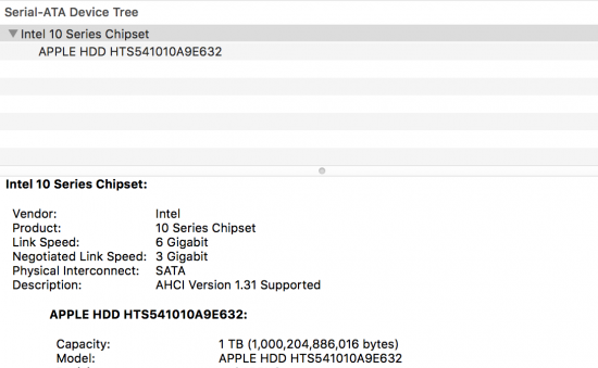

Perhaps could have uploaded a better image about the "black label" version of the 5K1000 1TB, here is a screen shot from MacOS showing that it only negotiates SATAII instead of SATAIII speeds within system info. This is HTS541010A9E632, while the one I have is HTS541010A9E680 (which negotiates SATAIII speeds instead causing an issue within the optibay).
Any help would be greatly appreciated.

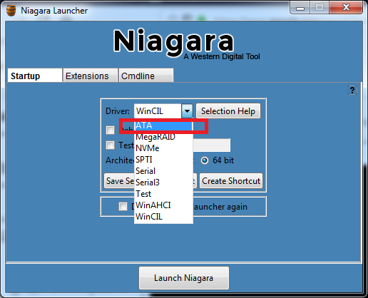

To update on the case so far, a windows reinstall solved the STPI recognition issue but know when I try to set it to Sata2 (or in fact try any other command) it just fails to send it in ATA mode:

I've just duble checked and currently running Niagara with Admin privilages within Windows.
Any ideas what I could be doing wrong here?
Re: HGST HDD 5K1000-1000 HTS541010A9E680 limit/change to Sat
November 17th, 2018, 11:29
Dear Spildit,
Well spotted, that is exactly what the issue was here.
Unlike Snackmasterx's drives, mine (the bespoke HTS541010A9E680) gets recognized using STPI driver but do not communicate with the controller correctly.
In order to resolve this I had to try in "ATA drivers" instead when opening Niagara (screenshot attached) and all was good from that point.
Unsure if this is an outcome of the combination of my Mobo's controller/Intel and/or the HDD's controller itself though.
Please also see the log for further reference from Niagara:

Thank you for your help, now the drive's negotiating SATAII speeds only :) :lol: :lol: :lol:
