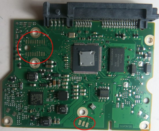

Without opening it, I do not know. It sounds vaguely like a motor trying to spin, which is why I tried the card thing. It almost sounds as if it comes from the PCB itself, which doesn't make sense, and it does it with the good board, too. The kicker is I used a piece of card to block the footings of the head pins (I'm not sure the proper name at the moment) and it still did it.

But it is very rare for that sound to occur if there is no power to the engine. Can you put an image of what you have covered?

You might be hearing background noise from the room. That rattle is the only only sound from the drive. It is very faint.
I used a picture from hddrecovery.com and circled the areas I blocked with a piece of card stock (not at the same time, obviously). In both cases, it still made the noise.
ETA: I decided to try the PCB off the assembly and darned if that sound isn't coming from the PCB itself. That's not normal, is it? I only tinker around with 2.5" drives and I've never heard that from the board. Blown circuit, maybe? But the good board does the same thing...
The board seems to send proper power. 12v and 5v at the diodes and 1.5v to the 3 motor connections.

December 13th, 2018, 8:05
If you hear high frequency sound coming from pcb, it might be due to some voice coils fault on the board.
Re: ST1000DM003 Completely Dead
December 13th, 2018, 8:20
If you hear some other kind of noise coming from pcb, then it might be some bad component near sata power connector as capacitors.
Can you post your real pcb pic in high definition?
