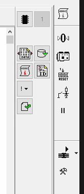

Sir is the V9 a rosewood? my utility seems different from the one on the link you sent me. i dont have PS Physical Heads map button
no physical.JPG (17.2 KiB) Viewed 9671 times
