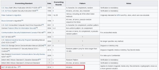

I do not agree with you. I think using pc3000 for disk eraser is only good if client is paying $ 500 per eraser otherwise its like using a AK47 machine gun to kill a mosquito . Ina typical enterprise customer there could 10000+ hdds erasing them with pc3000 will take ages. Instead with dedicated hardware /software one can erase no. of disks at a time. One can even use ATA commands (secure erase) .
There is no guarantee that whether disk is properly erased by degauser as there is no process log to confirm the same.
I think and as per US NIST SP 800-88 rev 1 one pass overwrite is more than enough to erase hard disk beyond recovery for most of the business level.
Recovery from remapped sector / overwritten track is not possible on commercial level and is important to CIA and pentagon only .For average users single pass overwrite ( zero fill ) is more than enough. (see attached pic)
