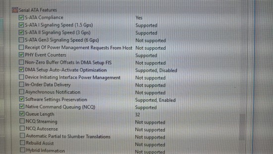

I have 2 of the exact same drives WD6000BLHX-01V7BV0.
The specifications everywhere says that they are 6Gbps.
After warranty is expired I noticed that they operate at 3Gbps only.
I tried different controllers - Intel X79 and Marvell 9128.
Different disk information utilities shows same frustrating values of “Maximum rate - 3Gbps” and “Current rate - 3Gbps”.
What’s wrong with them? Should they be this way? How can I achieve 6Gbps that are promised by all the stores that have them?

Spildit, Both X79 and Marvell 9128 have 6Gbps ports. Cable has "SATAIII" label on the connector.
I found this image on support.wdc.com but I have never tried to use jumper, so I always had none installed. Should I put one somewhere? Will it do any difference?
If you'll say that jumper is useless, how can I "switch" this drive to 6Gbps using "vendor specific command, vendor utility"?

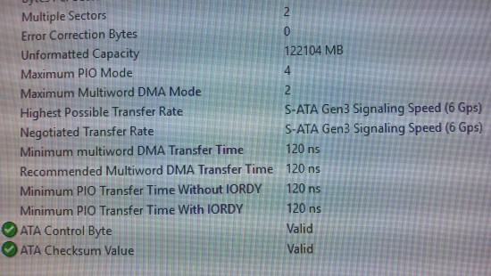

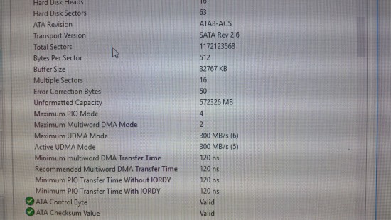

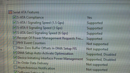

Spildit, I tried to connect other drive (SATA-3 SSD) to the same SATA-3 X79 port. I use sata cable with 6Gbps label on the connector.
First two screenshots (from HD Sentinel program) are WD6000BLHX, second two screenshots are SSD drive (connected to the same port with the same SATA cable).
As you can see the port and cable supports SATA-3.

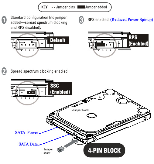

Fifth screenshot is an image I found on WD support describing jumpers for mobile drives. What do you think, can adding a jumper change something?
If not, how can I issue that "vendor specific command" that you were talking about or use "vendor utility"?

I also tried setting a jumper to SSC and RPS just in case. Didn't helped. Maybe it's possible for you to connect via TeamViewer and try something out?
