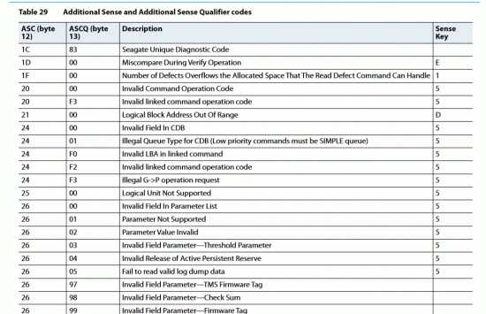

i stripped off the first 0x1A0 bytes of the file. Tried flashing and got these errors;
ubuntu@ubuntu:~/Downloads$ sudo hdparm --fwdownload D_ST33000651SS.LOD --yes-i-know-what-i-am-doing --please-destroy-my-drive /dev/sda
/dev/sda:
SG_IO: bad/missing sense data, sb[]: 72 05 20 00 00 00 00 1c 02 06 00 00 cf 00 00 00 03 02 00 01 80 0e 00 00 00 00 00 00 00 00 00 00
AND
ubuntu@ubuntu:~/Downloads$ sudo sg_write_buffer -v -m 5 -I D_ST33000651SS.LOD /dev/sg0
tried to read 8388608 bytes from D_ST33000651SS.LOD, got 990640 bytes
will write 990640 bytes
sending single write buffer, mode=0x5, mpsec=0, id=0, offset=0, len=990640
Write buffer cmd: 3b 05 00 00 00 00 0f 1d b0 00
Write buffer:
Descriptor format, current; Sense key: Illegal Request
ASC=26, vendor specific qualification ASCQ=98 (hex)
Descriptor type: Field replaceable unit code: 0x0
Descriptor type: Vendor specific [0x80]
00 00 00 00 00 00 00 00 00 00 00 00 00 00
Write buffer failed: Illegal request sense key, apart from Invalid opcode

Checksum mismatch error

Re: Generic Seagate HDD to NetApp HDD
March 26th, 2019, 3:52
xdvst8x wrote:Sense key: Illegal Request
Just to elaborate on what has already been stated …
SCSI Commands Reference Manual, Fibre Channel (FC), Serial Attached SCSI (SAS):
https://www.seagate.com/files/staticfiles/support/docs/manual/Interface%20manuals/100293068k.pdf
ASC (byte 12)  ASCQ (byte 13)  Description                         Sense Key
26             98              Invalid Field Parameter—Check Sum   5
