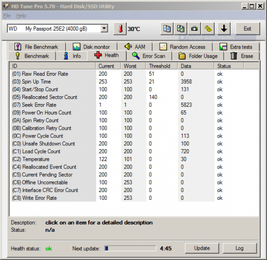

Re: Western MyPassport unlock possible bot no access
March 26th, 2019, 11:27
Check the SMART data. Do you have data recovery hardware tools such as PC 3000?

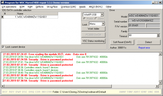

HI,
WDMarv wont let me access to the disk. It says -> Drive is password protected. See Pic
I can read the Smart Data with another tool. See Pic
I dont have a PC3000. I asked already for an offer but that was to expensive.
Is it possible to handle it with WD Marvel? If its working with it i wanna buy the livetime licence for it. Or do u have some better tools to handle it?
best regards
Fabian
March 27th, 2019, 16:41
Spildit wrote:Most likely you will not be able to do anything with this drive at firmware level even with the latest version of PC-3000 ...
Just outsource the drive to someone who can recover from it ?
Exactly, even for pro with latest PC3000 these are a nightmare.
So DIY is right out of the question on this one :-(
