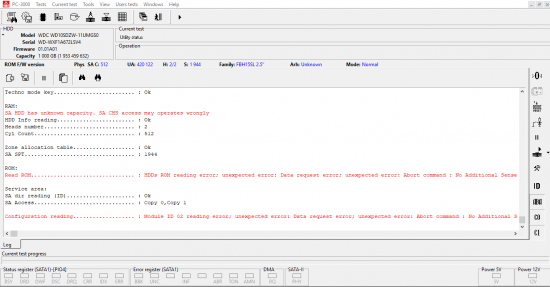

Hello guys,
Does anyone know what is the family name for this model WD10SDZW-11UMGS0?
I think my version of PC3K doesn't support this one.
My drive has unstable heads but it can read full ID but without right Family I can´t do anything in SA.
Thank you for your time,
Best regards.

i think this has hardware lock. you should use unlocked PCB instead of original PCB
Re: WD10SDZW-11UMGS0 PC3K Suport this family?
April 4th, 2019, 3:51
It's a new currently unsupported Palmer family HDD.
The SED is in MCU in such drives, it's not possible to unlock it using the PC-3000.
I bought a SATA compatible drive WD10SPZX to change ROM and if needed Heads.
When i made the tests i will reply the results for future cases.
