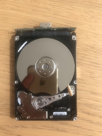

Id need some help diagnosing the fault/s of my Samsung ST1000LM024 HDD.
It stopped working after a fall some time ago. When plugged in the light turns on and it beeps but it wasn't recognised by the computer.
After watching some youtube I came to the conclusion the head must be stuck on the platter, I carefully followed some instructional videos and opened the hard drive and this was true. I unstuck the head carefully and put it back together.
I have attached a photo of after the fix so you can see inside and after i closed it again.
Here is a link to a video after I tried it out again:
https://youtu.be/ifRXYbi4tyw
The computer beeped recognising something was connected but the drive didn't come up in explorer or disk management (PC) and you can hear the drive making clicking sounds.
I'd like to fix this myself if possible so if anyone can tell me whats wrong or the next steps to fixing it id be very grateful.

I'm sorry to say that it can't be fixed by you and now it's going to be challenging to be fixed by someone who knows what's he's doing.
With all respect, you've taken all the wrong steps here.
If data is valuable, you might have some chance if you send it to a very good pro, but expect to pay big bucks.

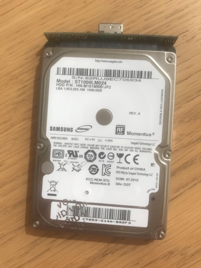

Did you see the VOID sticker on the drive. Its already been to a DR company, so presumably the OP thought it too expensive and decided to do it himself. Hopefully his data is not important.

Having dropped the HDD may have caused serious problems in the dishes and heads.
Removing the heads attached to the plates may have caused additional damage to the plates and / or heads.
This can be a difficult case to recover, so if you do not have the right tools the possibilities are very low.
At a minimum you have to obtar to get a donor, and change the heads, but you have to have the right tools, experience and get the right donor.
Once I have done this process and it is successful, you may find that the firmware fails to recover the information even if you have the experience and the right tools.
I think it's a difficult case.

Anyone else find that the >90% success rate of these drives with stuck heads (without needing donor heads) goes down drastically (almost always needing donor heads) after clients try it first?
Their attempt to save money costs them more and the amount of data they get back is usually less.

Did you carefully remove and inspect the heads under a microscope for damage? If the heads were damaged and you powered it on, it is very bad.

You Made a Mistake And Underestimated The Work ,And Saw The Video Of That English Guy How Says It This Way " Head Stuuuuck " ,Kindly Remember Once Head Is Stuck And You Unstuck It ,You Are Suppose To Inspect It After Removing It Under The Microscope , So No Laminar , No Experience , No Procedure .I Will Show You What It Takes To Solve Such a Issue ,Do Checkout What i Say In This Video Time And Again

i can see the DR lab stcker on the lid.
did they(DR company)open the hard drive before you open?
what is the 1st time symptoms. same symptoms like beep?? i mean before you opened.

Dananjaya - this was a new hard drive and i was the first to open it. Before opening it the power light flashed and it made beeping noises.

Where did the VOID sticker come from?

Those drive come inside the lacie enclosure and have a guaranty sticker on them attache to the frame
