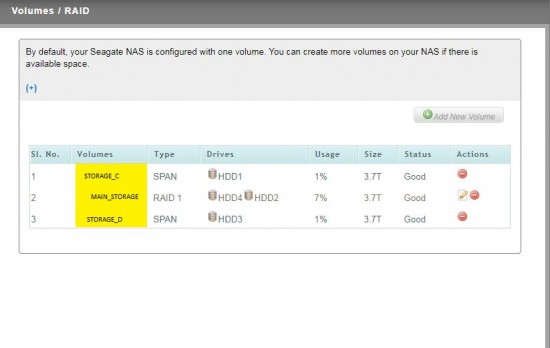

Hi gurus, I have Seagate Nas server with 4X 4TB, looking for deleted files, I got the image of the disks. Even Nas server can be reconfigured after deleting files, nobody knows. What are the default settings for these models?
I want to look at using r-strudio or UFS, but I'm a little confused about raid parameters. Is the following method "Span of storages JBOD with spanning"sufficient with UFS? any advice would work.
Respects
- Attachments
July 25th, 2019, 3:53
Storage_C and Storage_D volumes located on alone drives, Main_storage volume located on mirrored HDD4 and HDD2.
And if it was NAS, each drive contain mirrored Linux FileSystem at teh beginning. Actual volumes with data, located also on linux partition but with offset.
And there is a big chance, it was LVM created array.
