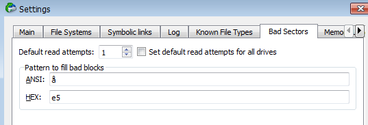

looks to me a shift on the beginning + bad sectors
did u made the clone with R-studio ?

HaspHL wrote:looks to me a shift on the beginning + bad sectors
100% clone with ZERO bads
Re: DVR Header ID
September 17th, 2019, 11:17
you didn't answer my question
HaspHL wrote:did u made the clone with R-studio ?
if so then the following statement:
einstein9 wrote:100% clone with ZERO bads
is not true
because R-studio uses (by default) "E5" as a bad sector pattern
Rstudio BS pattern.png (9.66 KiB) Viewed 24202 times
