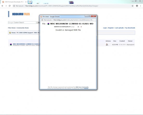

September 23rd, 2019, 7:56
digisupport wrote:Have uploaded charger 6004T here http://files.hddguru.com/download/PC-30 ... y/Charger/
Unfortunately, I downloaded the rar file but it gives error when opening :
Re: Charger
September 23rd, 2019, 8:19
Just tried to download the file and unpacked with latest winrar, no errors found.
Its packed in rar version 5. Let me know if it works for you or I can upload it in older version.

Re: Charger
September 23rd, 2019, 8:22
try downloading it onto your PC and open with 7-zip, WinRAR etc
Re: Charger
September 23rd, 2019, 9:23
Thanks a lot guys.
Problem already solved. :)
