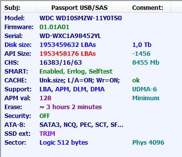

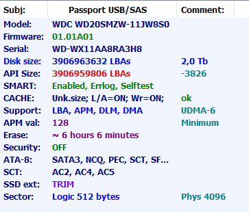

Deleted is deleted. Also if you check these drives will report they support "TRIM"
Charger TRIM

digisupport wrote:Try it on a new Palmer or Charger drive, you will get the same result.
I saw it in properties TRIM at Rstudio.
So No change to recover with known information about this drives ?

ISTM that one could determine a drive's TRIM support and subsequent read behaviour by examining Identify Device words 69 and 169.
IDENTIFY_DEVICE_DATA structure contains the data retrieved by an ATA identify device data command (0xEC):
https://docs.microsoft.com/en-us/windows-hardware/drivers/ddi/content/ata/ns-ata-_identify_device_data
USHORT ReadZeroAfterTrimSupported : 1;
USHORT DeterministicReadAfterTrimSupported : 1;
ATA/ATAPI Command Set - 2 (ACS-2):
http://www.t13.org/documents/UploadedDocuments/docs2011/d2015r7-ATAATAPI_Command_Set_-_2_ACS-2.pdf
The reasons for the desirability of deterministic read behaviour after TRIM are explained in the following article which raises several security concerns:
TRIM: Behavior of Subsequent READs:
http://www.t10.org/ftp/t10/document.08/08-347r1.pdf
