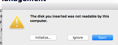

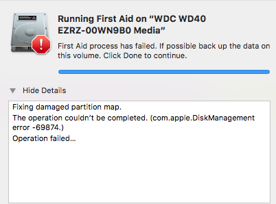

The drive was mounted inside a WD My Book enclosure. This device does not power on at all and suspect that it's system board was fried. That suggests then that the HDD inside was similarly impacted. Taking it out an putting it onto a USB SATA cradle, MacOS says the drive cannot be mounted, needs initialization etc., then I ran disk utility and got an error when trying to fix the MBR. Disk Utility did see the two partitions but neither could be mounted.
Took the cradle and plugged into a Windows 10 machine but just got the prompt the drive was not recognized and needed to be formatted.
The disk when it was working was formatted as ExFAT to allow both Mac and PC to read and write.
So I guess my question is where do I go now? I have had crashes before but most of them were mechanical and catastrophic, or I was able to run a chkdsk command. It's been awhile and I do not want to make my issue worse without getting some expert input to my problem.

Don't let your tools "fix" anything. Doing so will only make the problem worse.

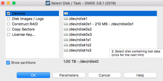

Can you show us the Partitions window in DMDE?
https://dmde.com/download.html

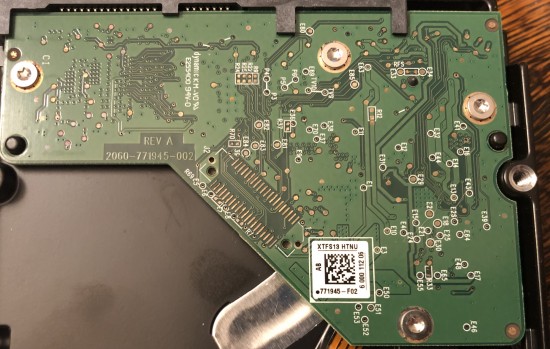

Can you upload a detailed photo of the PCB from the enclosure?

OK I am going to grab that app and send the report. Meanwhile, here is a photo of the board

OK I am attaching screen shots from the time the drive is connected to my Macbook. First the system says the volume is unreadable, to which I select Ignore, and then what I see in the DMDE interface. I'll await your interpretation on this.

jdanham wrote:here is a photo of the board
fzabkar wrote:Can you upload a detailed photo of the [component side of the] PCB from the enclosure?

Hello all - I've been out for a bit, so here is some additional photo information as requested. Hope this helps. Also I am attaching what I saw in Disk Utility on the Mac.
Aside from the obvious, I am quite concerned that the partition sizes showing are smaller and don't add up to 4TB.

Your drive has two unencrypted partitions, but your enclosure's 4KB sector size is the reason that they are seen as being 8 times smaller than they actually are (512B x 8 = 4KB).
    8 x (249.94 GB + 250.11 GB) = 4.0004 TB
You can recover your data with DMDE, or you can purchase a bridge PCB from a 3TB+ My Book Elements.

Just to be sure, in DMDE double-click each Volume and expand the Root. Do you see your file/folder structure?
Could we at least see the initial Partitions window?

I hope this is what you were looking for. Since the drive is connected to a USB cradle, not via the WD board, is this all just that default encryption that is preventing me from seeing my files? If there is any other DMDE command I can run to provide more details, let me know!

And just to answer the question, the file/folder structure is clearly not visible...
