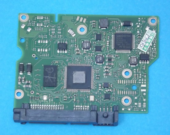

Hello friends. I'm here only to be sure that my diagnosis isn't erroneous.
This Grenada came to me with the PCB completely destroyed by an IT store.
Changed the PCB and I'm getting this on terminal:
Boot 0x40M
Spin Up
RECOV Servo Op=0100 Resp=0005
TCC-001E[0x000042F9][0x000042F9]ZZZZMMMMMMMMMMMMMMMZZZZZZZZZZZZZZZZZZZZZZZZZZZZZZZZZZZZMMMMMMMMMMMMMMMMMMMMMMMMMMMMMMMMMMMMddddddWW
PreampFaultStatus = 0000YWMMMMMM
Drive doesn't sound weird and stays on BSY all time.
This is clearly a preamp problem, right? Is there any chance to be anything else?
Thank you so much for any reply.

Where was the damage on the original PCB? If the 5V TVS diode is shorted or missing, then the preamp may have been damaged as well.
Check the ROM's CAP module for the serial number and model number.

fzabkar, It were totally destroyed. Some animal tried to "reflow" MCU and drive controller chip. Lot's of poor flux. It was a mess.
But it really can be other PCB, not the original, judging by what they made to this poor PCB.
I'm sending the ROM .bin. Where exactly should I search for serial and ID?
On label serial is Z1D09FLM
PN: 9YN162-570
FW: CC98
Thank you again for all your help.

This PCB has two SOIC 8, one next to the other.
My donor PCB have two, but the original PCB came with only one.
What is the difference?
The PCB is 100664987 REV B

parmindo wrote:This PCB has two SOIC 8, one next to the other.
What are the markings on the ICs?
