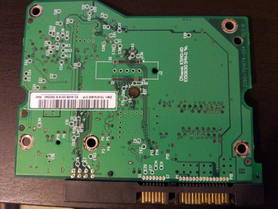

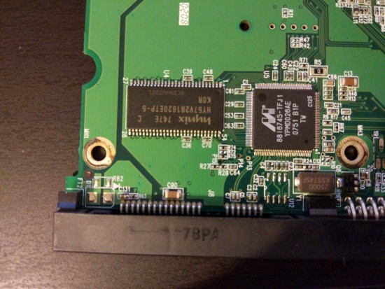

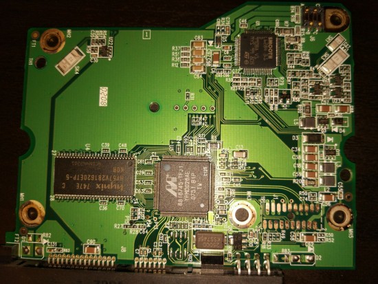

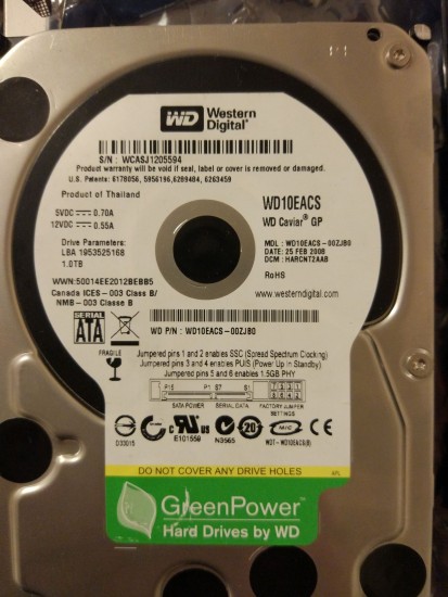

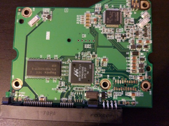

My pc had electrical failure years ago and as a result my mobo and hdd got burned. Even though i got lots of old pictures, files etc. on this hdd i had left it on my shelf for years cause i thought it needed professional help (maybe it still does i'm not sure). Than, lately i decided to take another look at the problem and while reading i discovered hdd's got fuse , tvs diodes or zero ohm resistors as protection. I hope my problem is simple as removing this fuse so i need your help. I added several pictures of my pcb, to me it looks pretty clean; no apparent char etc. Please let me know if you see another problem on pcb cause i'm just guessing the problem with my newly obtained info about hdd's.
I removed this drive from old western digital my book portable drive case. I don't know much about electronics but i couldn't locate any zero ohm resistors or tvs diodes near power connector. Only thing i see is resistor R63. Is it the fuse i'm looking for?
I will get my pcb to local electronics shop (cause i'm not sure if i can find experinced pc hdd shop in my town) and get the fuse tested if i can locate it with your help. If I'm right, i should get that fuse removed and get wire etc. between two nodes of fuse right? I know doing this removes protection from secondary failure but I'll immediately transfer files and i'm pretty sure my mobo and pc is safe right now.
Thanks in advance.

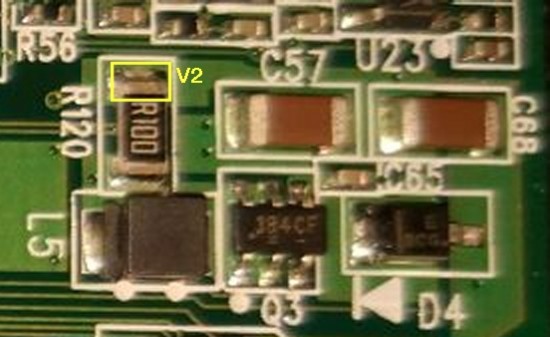

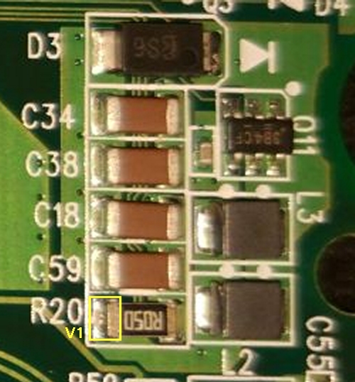

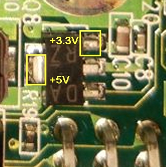

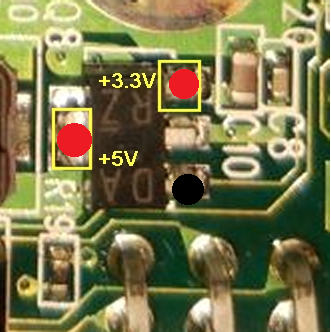

With your PCB off the drive, and powered up, can you measure the voltages at V1, V2, 3.3V and 5V ?
Also measure the +5V and -5V pads at the HDA connector.
Re: Need help with locating fuse on wd green hdd pcb
December 2nd, 2019, 16:14
Okay i had to google to learn how to measure things you asked but i think i figured ? please clarify for me
For V1 and V2, i put my black probe to one end of resistor and red probe to other end of resistor right ?
If that's correct :
V1: 5.32 V
V2: 5.32 V
Than for Smd transistor , I did like in my attached photo (black probe on bottom right leg of transistor (i guess its GND?), and red probe on legs you showed on your markings):
For +5V : 4.28 V
+3.3V : 0.007 V ?
Checked pads also (i did it like HDA pins (black probe on gnd pad - red on +5V and -5V) also pcb was powered )
+5V : 5.32 V
- 5V : 0.5 V
December 2nd, 2019, 17:45
The black probe goes to ground, eg a screw hole.
December 2nd, 2019, 18:50
Okay did it like that, most of the readings stayed same :
V1 : 5.32 V
V2: 0.000 V ( I get 5.32V if i measure other side of the resistor but no readings from where u marked)
5V: 5.32V
3.3V: 0.456 V
Pads :
+5V : 5.32 V
-5V : 0.510 V
December 2nd, 2019, 19:04
The motor controller chip is dead.
December 2nd, 2019, 22:13
The motor controller (SMOOTH) also controls the power supplies. All three power supplies are bad, so the SMOOTH IC is the common factor.
Unfortunately there is no chip at location U12 (the "ROM"), so a firmware transfer is not possible for your PCB. Instead you would need to regenerate the ROM from the System Area (SA) on the platters. That requires specialist tools, eg WDMarvel, but it is not a straightforward DIY procedure.
