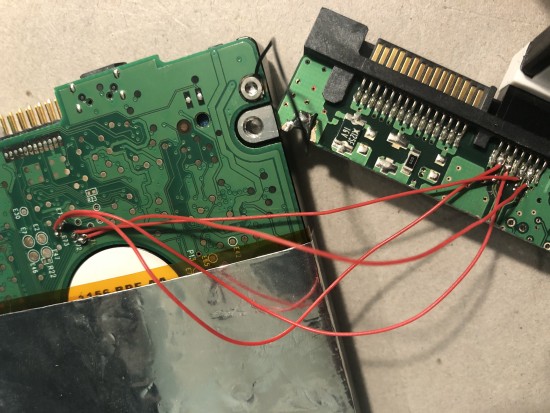

Hello everyone,
I found in a one of my drawers a WD Passport Essential which is containing photos, and financial informations. It was untouched for many years until today and of course, I don't remember the password.

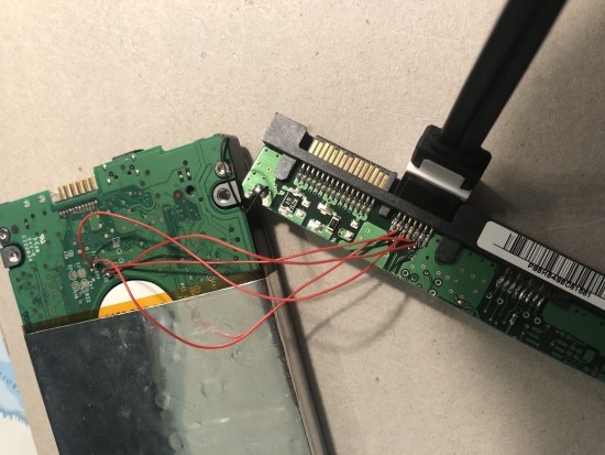

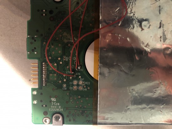

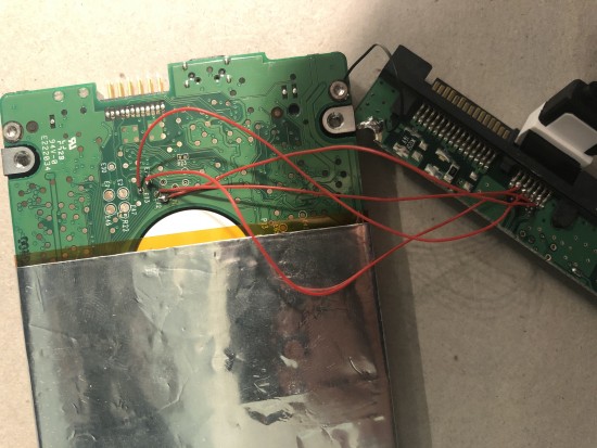

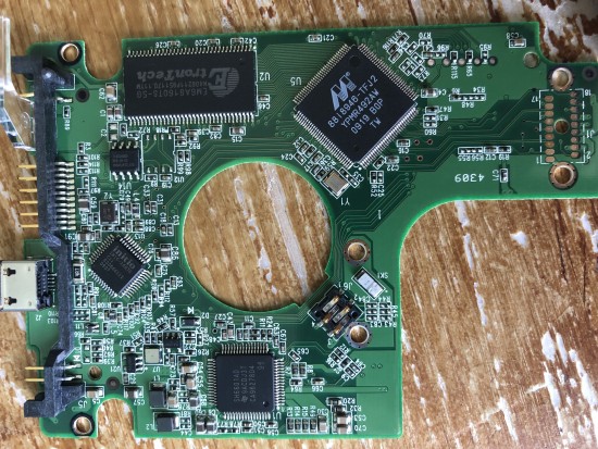

After many researches, I found out that this drive has an Initio INIC-1607E and there is a vulnerability which would maybe let me recover the data. To perform the decryption, I need to extract the encrypted DEK (encryption key) at the sector 1465143304 (because it is the 750Gb drive) to bruteforce it (which is possible because of the vulnerability). To do so, I removed the capacitors C13/C18/C31/C33 and soldered wires to E71/E72/E73/E75 and the ground. I then connected the sata port and the USB (for the power) to a computer and nothing. On two different motherboards, the drive isn't detected in the bios or in linux with fdisk -l. I can hear it spinning but nothing from the reading head. I checked my connections and nothing weird. What do you suggest?
I join pictures to show you the situation.

I haven't checked your wiring, but you could use the following SATA PCB, with the same MCU, to follow the tracks from MCU to SATA connector.
https://images-na.ssl-images-amazon.com/images/I/71MqebSA8aL._SL1296_.jpg

I think those wires are too long, they've to be very short (less than 4 cm).

January 19th, 2020, 12:42
@Michael Thanks for that suggestion, I will try this solution when I'll have a bit more time.
What should I see in Linux ? Something which looks like as a normal WD drive ?
